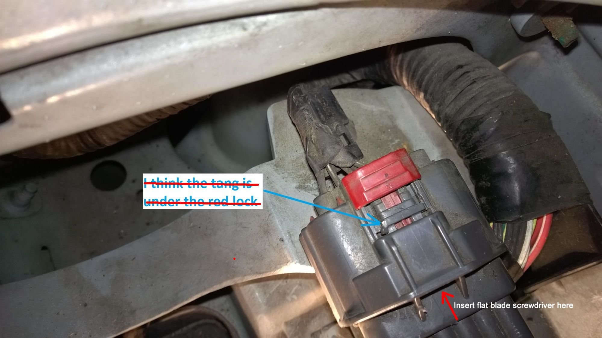

For those that still have an issue, this is what I discovered:
the red slider must be slid back towards the rear of the vehicle,
a small wedge (small flat bladed screwdriver) needs to be inserted into the rectangular hole in the plug (not the socket with the red slider on it) from the front of the vehicle, this is visible on top of the wires going into the plug that needs to be pulled out.
There is a tang inside that rectangular "tube" section that must be pulled downwards to release the plug that then needs to be wriggled out of the socket. Mine was tight, but came out with a effort.
the screwdriver needs to hold down the tang inside the top face of the opening arrowed in red
