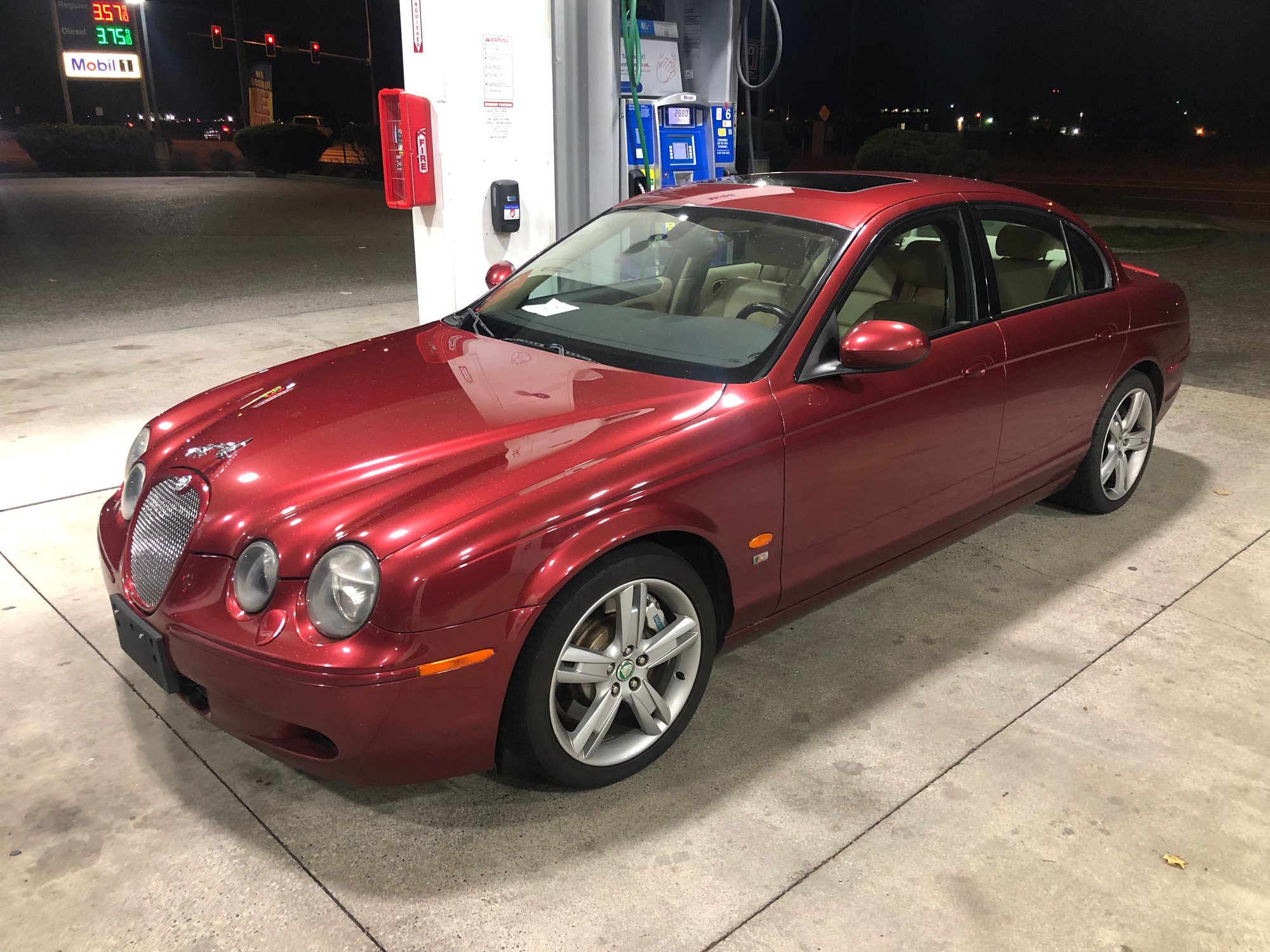

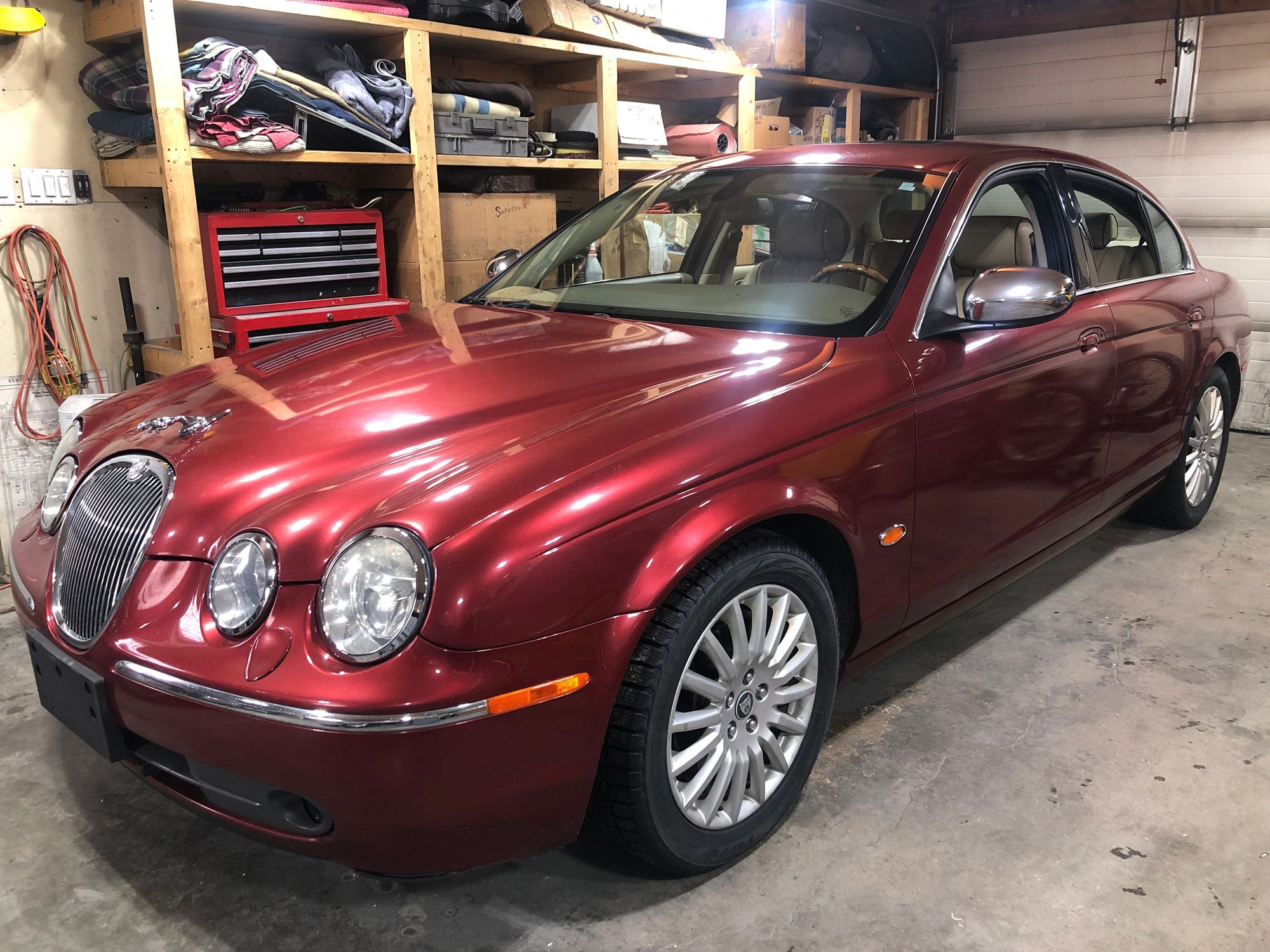

Sorry, I attached a photo of my previous 2005 S Type. It definitely was not an R. Here is a photo of my R. Same year, same color.

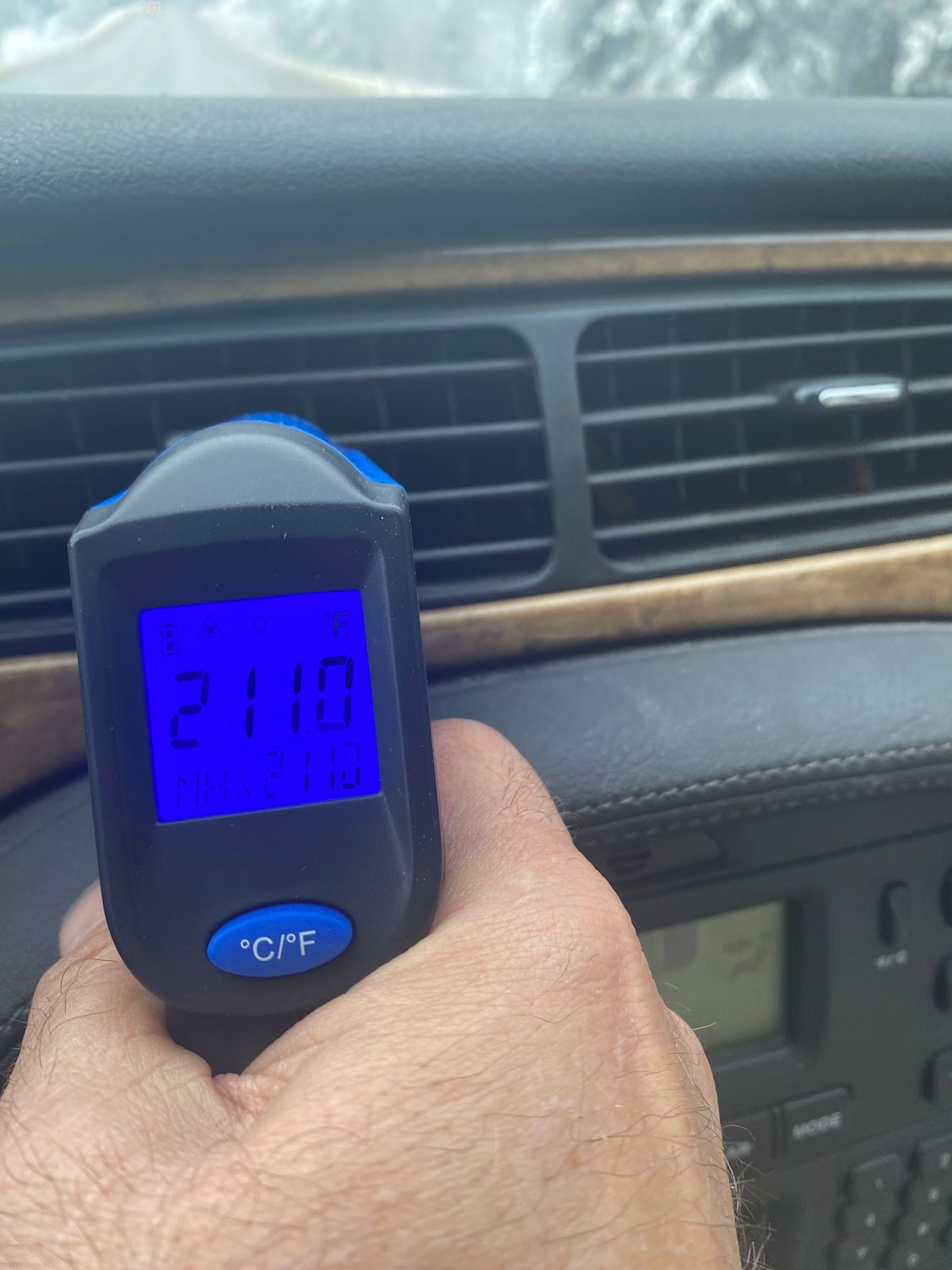

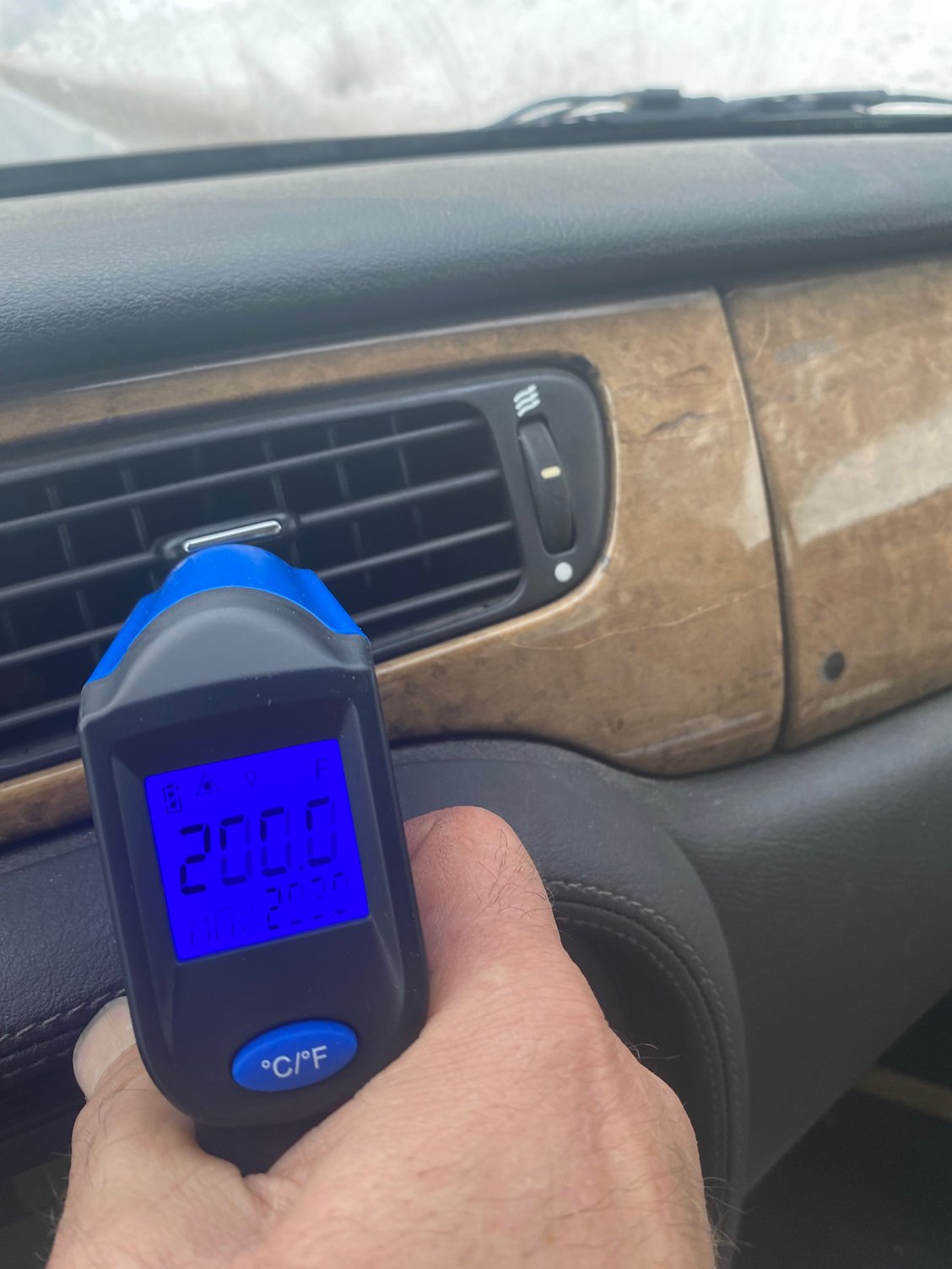

No problem making heat! Set on HI with AC off, driver’s vent is 211. Passenger’s is 200.
