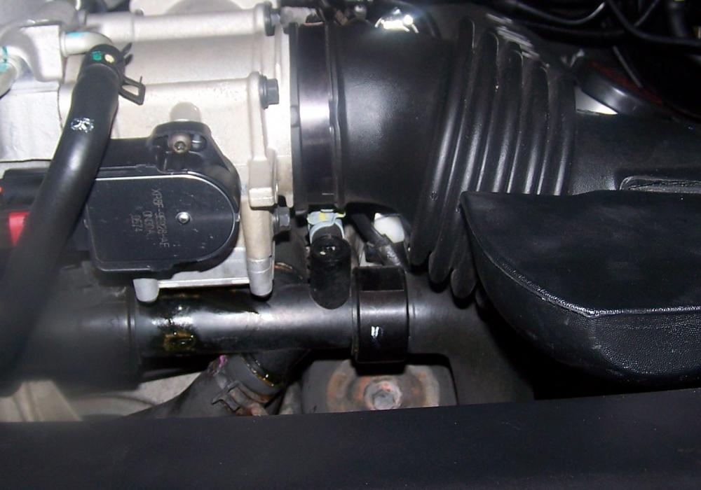

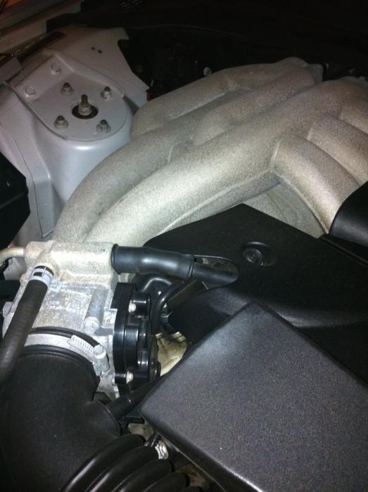

The valve is on the pipe coming out of the right side of the throttle body (at least on my 2003) its actually a metal pipe, not a hose. You need to remove the plastic engine cover / oil fill cap to get to it.
I took a quick pic of my motor. Look at the throttle body, see the rubber sleeve going to a metal pipe going under the engine cover exiting the right side of the throttle body? That's the pipe it's on.
You need to turn it about 1/2 turn counter clockwise to pull it out, standard flat blade screwdriver. To get it back in line it up about 9 O clock and you'll feel when the threads catch.
Hope this helps,
George

That's half the equation. There are two bleed valves on a 3.0.
Read the pdf I posted again.. The bottom where it says LHD 3.0 Vehicles only.
Line / Step 7 and 8.
The bleed valve you are talking about is the heater bleed valve. Mentioned in # 8 - this is also where you bleed the heater core / do the 2nd part where its running and you bring it up to speed etc.
The bleed valve on the engine crossover pipe mention in # 7 is on that pipe mentioned in my picture.
Make sense?
George

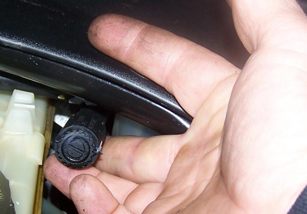

Your right, many thanks again found it and took pictures
