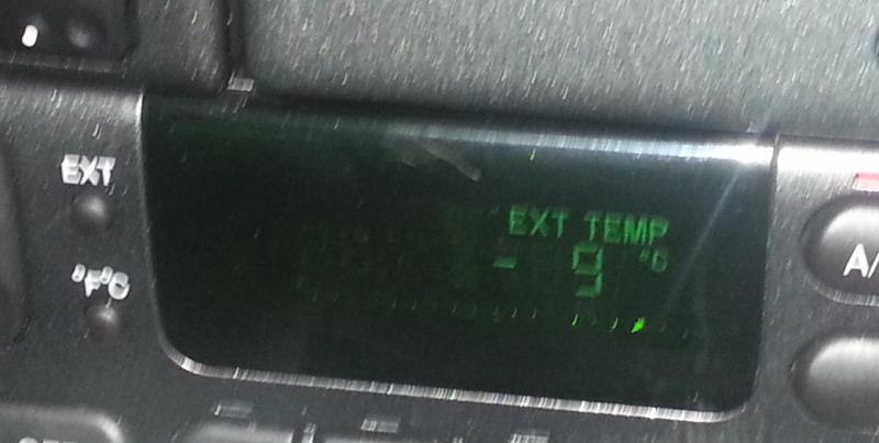

Likes: 222
From: Liverpool, U.K.
they defiantly freeze up, i had undiluted concentrated screen wash in and it still froze at the nozzles and on the windscreen wipers and windscreen, although once i put the blowers on just the windscreen it no longer froze on the windscreen but still froze at the nozzles and wouldn't spray
it was minus 9c (cold for england but warmer than some places)

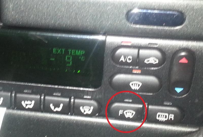

Old Dec 14, 2012 | 08:26 PM
police666's Avatar
Joined: Nov 2011
Posts: 1,154
Likes: 222
i think i have that, or at least a button that lights up to make me think i have it
That button operates the heated front windscreen on my S
I must admit I was wondering about heated washer nozzles myself yesterday!

Old Dec 15, 2012 | 11:02 AM
clubairth1's Avatar
Community Influencer
Posts: 12,144
Likes: 3,390
From: home
I think that switch was the front defroster but does the windshield have the fine wires like Mikey posted?
On my 2005 when I hit that button it turns the fan on high and directs 100% of the air flow to the windshield defroster ducts.
Old Dec 15, 2012 | 11:30 AM
police666's Avatar
Joined: Nov 2011
Posts: 1,154
Likes: 222
i have not got the heated windscreen, i have had them fitted to a few of my fords, its the only thing i miss from them.
