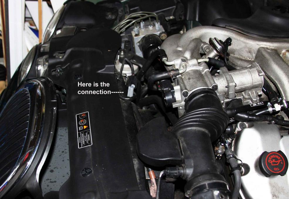

Still running great!!! I continue to look at Engine on daily basis to see if anything I put back together starts leaking and found a connection I am not sure about. Here is a pic of it, gray in color with two wires feeding it. Can someone give me an idea? Also only warning I get from computer is my washer fluid is low. I checked it and its full. Any thoughts on why I am getting this warning or how to correct it? Thanks.

Mike, our '05 doesn't appear to have that connector. Sorry buddy.

Thanks Rick, my thought is when checking all the codes do the techs plug into that port under the front dash or do they plug in somewhere else to get the readings and maybe its this connection? The way its wired and set up, it really has no place to go as it is. My washer fluid level, not sure other then a fuse or a clearing of a fault code? Just guessing. Could not find any posts in reference to the washer fluid level on the site.

They plug into the DLC (OBD-II port, in the cabin). You may need another pre-facelift V6 to compare with for that loose connector.

I just got my car back and will need a wider photo of where this plug is to identify it.

Thanks Gus, here is the pic. Its the gray looking thing. please refer to pic in beginning of post for better view of connection. Problem is nothing near it to attach as far as I can see so that is why I thought maybe attaching to an external port of some kind. I did change the fuse with a new one and still get the warning on the screen showing low fluid level in washer. Have a code reader that does allow me to clear codes and have not tried that as of yet

Well I found the same connector and as best I can tell this plug is used as a test point. I will look into and get back with you. It does not look like it has fallen of part of another unit.

Someone else with a pre-2002/3 V6 (so, 3.0) should be able to figure that out
I'd have that black plastic cover off just in front of it - the cover over the radiators. There are about 4 fasteners with cross heads that twist undone. Maybe there's a mating connector hidden beneath. If there is, I would NOT join them up! I'd want to figure out where the parts go and then do some tests in case there's a fault that someone "cured" by disconnecting the parts.

I was at Jaguar and they told me that if your car was a V8 4.0 then it would have an additional water pump for the heating system and that plug was for it.

It looks like the factory timing jumper. On the Fords I have had they have one or more of these. When you set the base timing of the car you need to pull the jumper to stop the computer from adjusting the timing. This will allow you to properly set the base timing before the computer starts adjusting things.
This is just a guess??

Thanks Gus and everyone else for the help. I did have that cover off Jagv8 when doing the other project and did look for something else it might connect to with no luck. And my car is a V6 so don't think it would be for another water pump. Will check out that wiring site Gus you suggest. Thanks.

What they told me was that the wiring harness is the same for the v6 3.0 as the v8 4.0. It was one of the mechanics that told me that.
