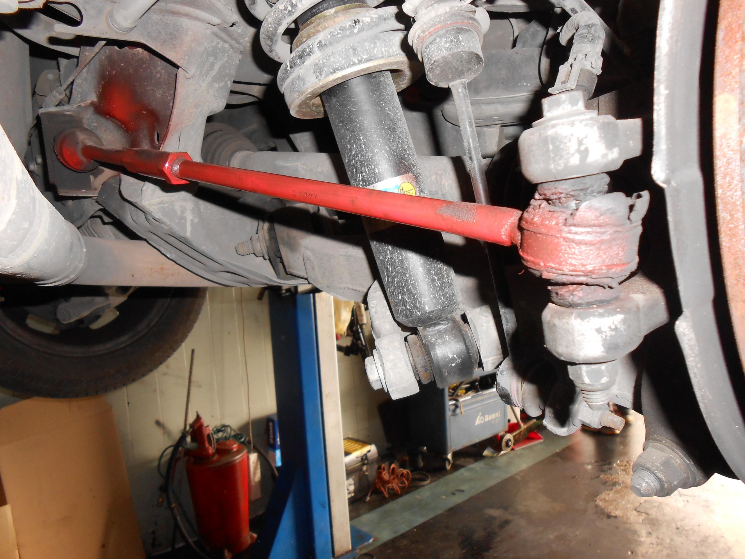

Hello everyone my dad has a 2003 Jaguar s-type v-6 model and he currently lives in Greece. He sent me this picture of the part hes looking for and i can't figure out what it is. I asked him for any number Identifiers but he says he can't locate any. Any help would be appreciated.

The red bar is the rear tie rod.

would this be the 1 i should order for him? Jaguar s Type Toe Adjustment Link Torque Rear Tie Rod XR825750 XR8 25750 1pc | eBay
It says you need 2 to do it right, a bit confused on that.

You need one for either side. Best change both at same time.
These are for 2000-01-02. you need to source them for an 03 if that is what he drives.
Jag made changes starting with the 03 models. earlier parts probably won't work.
The ebay listing has a VIN number listed that these will be good for. It shows 03 but you better get the VIN and compare before buying.
