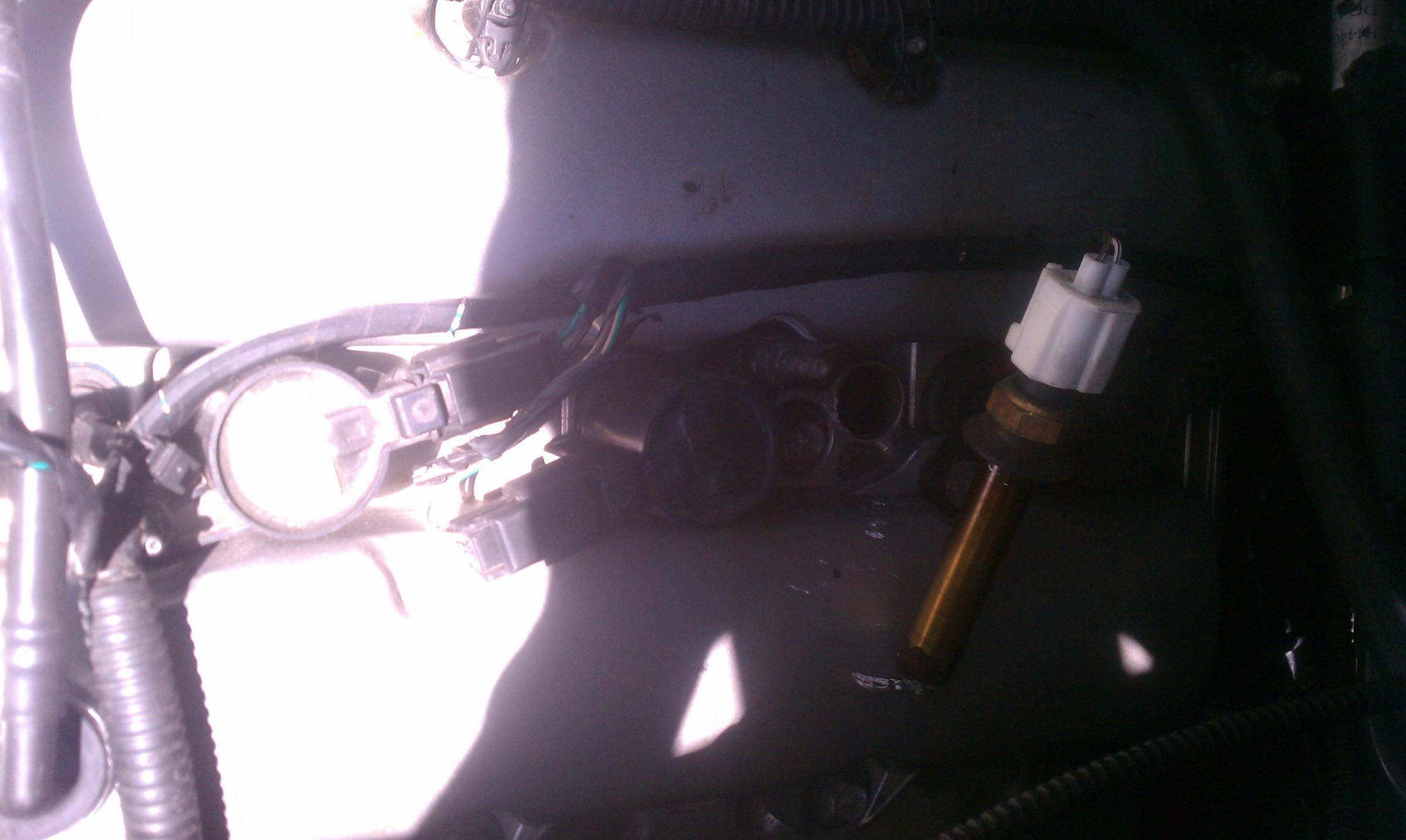

I was driving on the way suddenly
I felt engine shaking badly
I checked the engine then I realize a coil next to ignition coil has poped out
Does anyone know what this part is and procedures to recover it?

I got a code of P0303
Misfiring on cylinder bank 3

That's not a coil, it's the head temp sensor. Any other codes? I can see it's a 3.0, but what year?

Thank you Jagtastic
It is a 2001 3.0 Jag
Do u know what are the consequences without temp sensor?
How to put it back?

I'd be wary driving it much without the CHT. JTIS may explain how it fastens. Free download.
