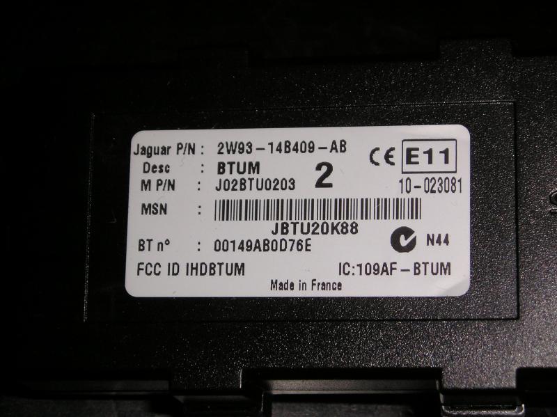

Hey Matt,
I've got an AB module if you want to give that a try. I'll try to ship it put tomorrow for $175 if that's kosh.
Cheers,

Steve, you da man! However, I must pass. A forum member who lives just east of me offered me his and I accepted, although a bit higher price. I'm going to keep my commitment to purchase his, cuz that's the way I roll.
Being 'posted' here though, I am sure some other BT seeker will take you up on your offer in a heartbeat.
As for me, my search has ended. (big sigh of relief)
