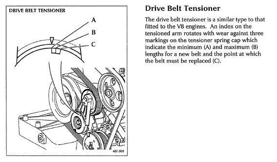

Look on the belt tensioner. You should see a set of indicator marks, typically cast in the main body and pulley arm. As the belt stretches in normal use, the indicator marks move out of alignment. This tells you the belt is now too long for use. It would also let you know if the belt you've installed is not the proper length. I have an excerpt from the manual showing this, but I can't find it right now.

Found the details of the drive belt tensioner. I think this is for an early V6, but there should be something similar on all models:
