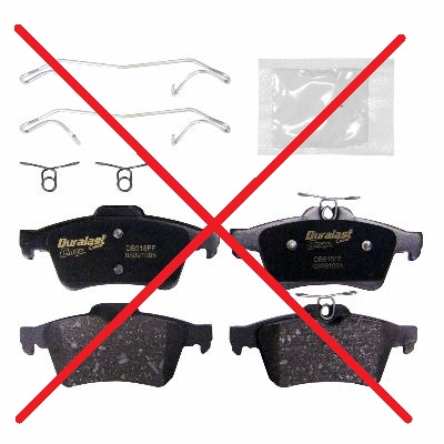

Sorry guys had technical difficulties yesterday.
I can't believe all the informative information that has become of this "screwed up". Thanks for all the replies! As some missed the screw up is fixed!
Thank you for your input Brutal! The rotors DID NOT fall below tolerance, otherwise I would have replaced.
Jeff, I don't think I can help you out with your clunking.
Jon there is more than 1/4" pad left on the old ones that I have now replaced.Heres a pic of the correct pads for our year:
not these:
Attached Thumbnails I screwed up-akebono-rear-pad.jpg   I screwed up-wrong-brake-pad.jpg

Rick,
Thanks for the photos of correct vs. incorrect rear pads. My new ThermoQuiet rear pads look like the ones in your correct photo. Since both Advance Auto Parts and rockauto.com say these fit, chances are good that I have the correct set in hand. Guess I'll find out for sure on the day I pull the factory pads off as part of my 60,000-mile service on our S-Type....

This is the "pin" I am refering to, that one that did not seat into the caliper piston correctly.

Yep, I see that pin on the new rear pad I am holding in my hand. Note to self: make certain those pins get seated properly when new rear pads are installed....
Thanks again, Rick....
