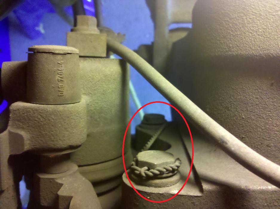

Keep us posted on how one can screw up the brakes from that end....we already got the gouge from another member on how to do it through the reservoir, bless his heart....
I ordered pads for the XJ this weekend....looked too labor-intensive to just pull the calipers and have a look:
Looks like it's "fun with twisty wires" for me in some weeks....but I won't start that until AFTER I find my "tuit" - yeah - - the ROUND one....and won't start searching for it since we find my daughter's keys

All Colonel Klink needs to add to your pic is some barbs to that wire......sheesh what is up with that??!!!! Chocolates will be needed

I was shocked too...looks that way on both sides! Fronts are not wired (nor drilled) though. I gotta consult Motorcarman. Wonder what kind of tool I need to put 'em back that way? "Thru-the-caliper" pics look like I have plenty of pad left, front and rear...so I'll get my pads delivered and think on it a good while before I bite it off.
Anxious to know what could be causing the clunk in yours (Joyce's)?

Safety wire ... keeps the bolts from winding out.
Another excuse for tool freaks to buy another tool because there is a special type of pliers that does the twisting for you while you just pull the pliers back.
Looks very well done. Notice the wire passing through the bight of the doubled up safety wire.
... or you can twist the wire with plain old pliers gripping the two cut ends of the wires. Gripping the wire mid run is not recommended in case you nick the wire.

I hate safety wire. I used to gun a Bushmaster M242 Chain Gun in the military and that thing was loaded with it every single bolt was safety wired. Man was that thing a pain to do anything on.
I venture to guess that the previous owner may have lost a caliper bolt and really didnt want to go through that again so took matters into his own hand. Wish I had snagged some of the tools I had while in I'd hook you up with them for when you are done. Here is what you will end up needing to make them look the same.
