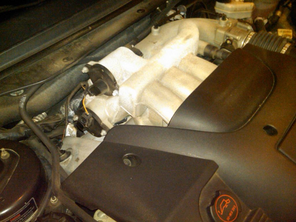

For those of you who want a better perspective on what you have to remove, here's the pic of the IMT Valves in the manifold of my X-type, which has the motor mounted transversely. They are easy to get to in the X, but getting to the rear (what would be driver's side) plugs on it is ridiculous.
Attached Thumbnails IMT O-Ring replacement (short route) w/pics FAQ-imtvalves.jpg

Received 0 Likes on 0 Posts
Where can you purchase the IMT o-ring online? Part no 'CZs 40669' I believe someone reported it being? Or, do you have to purchase from Jaguar/Ford dealership? Thanks.
  #34
Old 05-12-2010, 11:10 AM
Amadauss's Avatar
Join Date: Aug 2009
Location: Pa
Posts: 477
Received 30 Likes on 25 Posts
Get from Jag dealer, should have in stock. About 3 dollars each and green in color.
