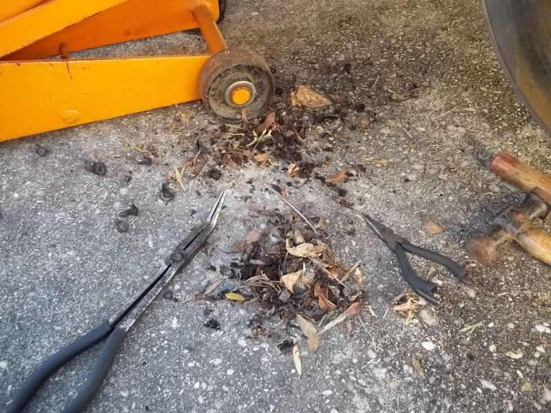

Wife let a drunk guy drive her car, he scraped a tree and got the passenger mirror and front fender, so I pulled the inner fender to pound it out. Found a leaf clog at the back where the firewall and right side engine compartment sidewall meet at the bottom. You can't see it from the engine compartment (maybe with a mirror?) Using pliers and fingers I got all of it out, was quite a bit in there.

Great post 55, thanks for sharing. What is the red cap covering in the picture?

Cap is covering the main battery lead that runs from the back of the car underneath to the front.

I was thinking the red cap was part of a wiring harness, forgot about the battery in the trunk. And the drunk guy wasn't me, thank u very much, he was a fellow in a bar the wife was reminded of her own son, and took a quick liking to, until he messed up her Princess. I was not very happy when I found out what happened while I was singing kareoke. I come from a long line of alkys, we are very accustomed to driving whilst inebriated, ala Dr Johnny Fever.
Originally Posted by aholbro1
Not sure..but this may be the bottom side of pocket of leaves I found in my wife's 05 when doing the IMT O-rings. I had pulled the cabin filter to vacuum the leaves out of it (it's still fairly new) and noticed a soft bed of leaves in the corner under the cabin filter housing. I got 'em out by alternately clogging the shop-vac nozzle, then picking them off, then repeat.....Sorry, didn't think to take pics.
Yes, I was thinking this is right below where the cabin filter is. I wonder if there is the same condition on the driver's side? Those leaves that collect in the cowl area have to go somewhere. Taking the cowl cover off and checking/cleaning the cabin air filter would be the way to check this conditon, the inner fender has 4 10mm nuts, 2 Phillips expanding clips, and 3 or 4 Torx bolts to remove. I should have put some lithium grease on all the bolts for future removal.
