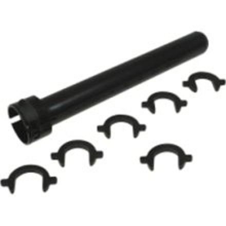

I have had to use a special wrench to remove inner tie rod ends on other steering racks. A standard way of checking the inner tie rod ends is to see if the inner will hold the tie rod in place or does the tie rod just drop as far down as it can?
Does the S Type need one too?
Mine looks like this with the different size crow foot wrenches.
Attached Thumbnails inner tie rod replacement W/Pics FAQ-inner-tie-rod-tool.jpg

Thanks but can you explain how to get it off? The special tool is really just a super deep socket so you can get on the flats of the nut.
Is there a roll pin to remove? All inner tie rods I have replaced are somehow staked so they won't back off. The new inner tie rod usually comes with a replacement roll pin.

say if it is the left inner needing replaced turn the wheel full right remove clamps on inner boot and slide boot off there is no pin just locktite put a wrench on the flats and turn counter clockwise,add locktite when installing new one
