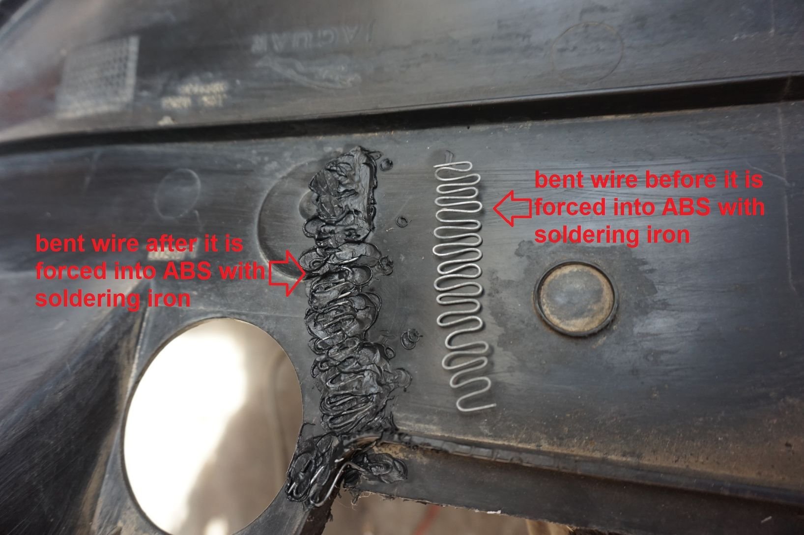

I just repaired the front-skirt under the engine of my S-Type - it was torn into pieces at many points.
I used an old soldering iron (and a face-shield at breathing protection (a breathing mask would be even better)), which I use for plastic repairs only. I made the tip of that soldering iron myself: I bought a copper bar and cut a short bit off.
I used a thin bit of wire and bend it by hand into the shape shown below.
I forced that bent wire into the ABS along the crack with the heat of the soldering iron.
I do that from the side, which is not visible afterwards.
After that first step I smoothen the other (good) side with the soldering iron.
Then I smoothen the side with the wire in with the soldering iron.
Then I smoothen everything with sandpaper.
Then I apply a bit of left-over ATF (automatic transmission fluid) or plastic restorer to make it look even better.

Originally Posted by Peter_of_Australia
I would not be too keen on trying out the method shown in the video, because they use Acetone, and Acetone is a carcinogen, i.e. it could very likely cause cancer.

Yes, using the wire-mat rather than my bent wire is another option.

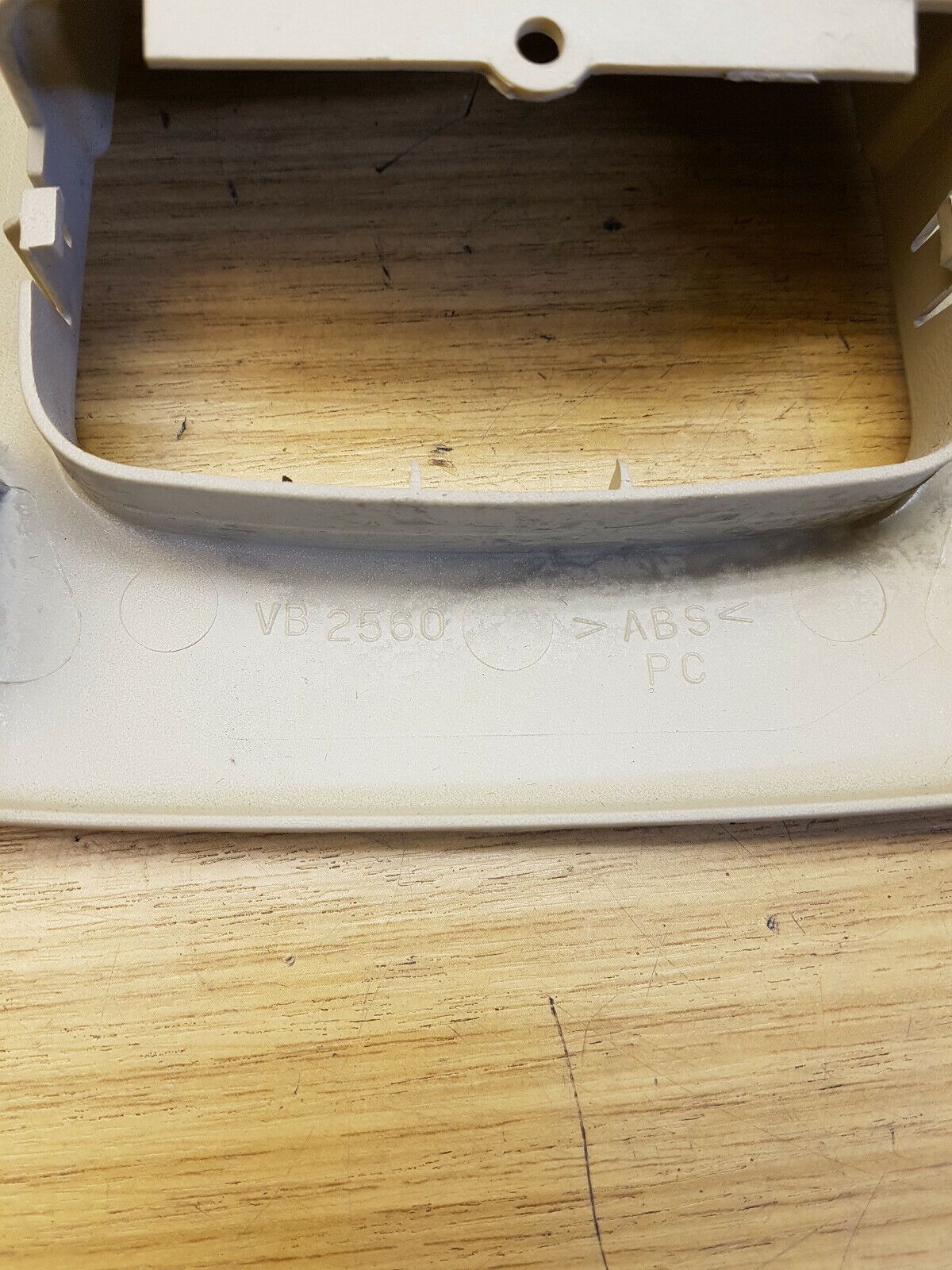

The day i was cleaning the interior and taking out all the damaged plastic parts i checked the back of them and all said "ABS".
At the end i will not use the method on the first video post, Acetone is a carcinogen as mention by Peter_of_Australia and saddly since my great grandfather almost all descendants have suffered or died of cancer (my Great granfather, Aunt, and my dad died from cancer, 1 uncle is right now with cancer and My grandfather survived two cancer) Probably inevitable but trying to avoid it at all cost
This photo was shamelessly stolen from ebay, it is from the rear air vent.
