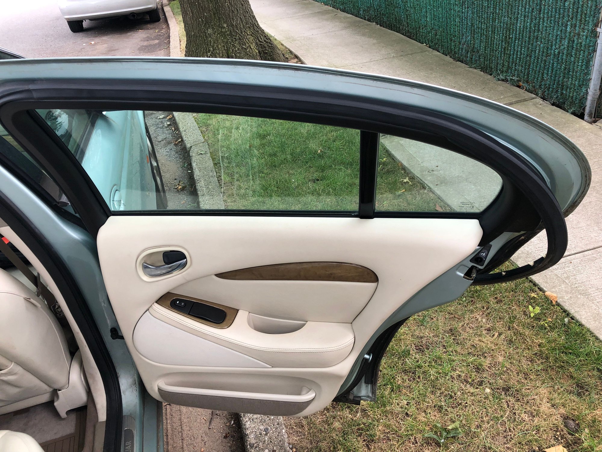

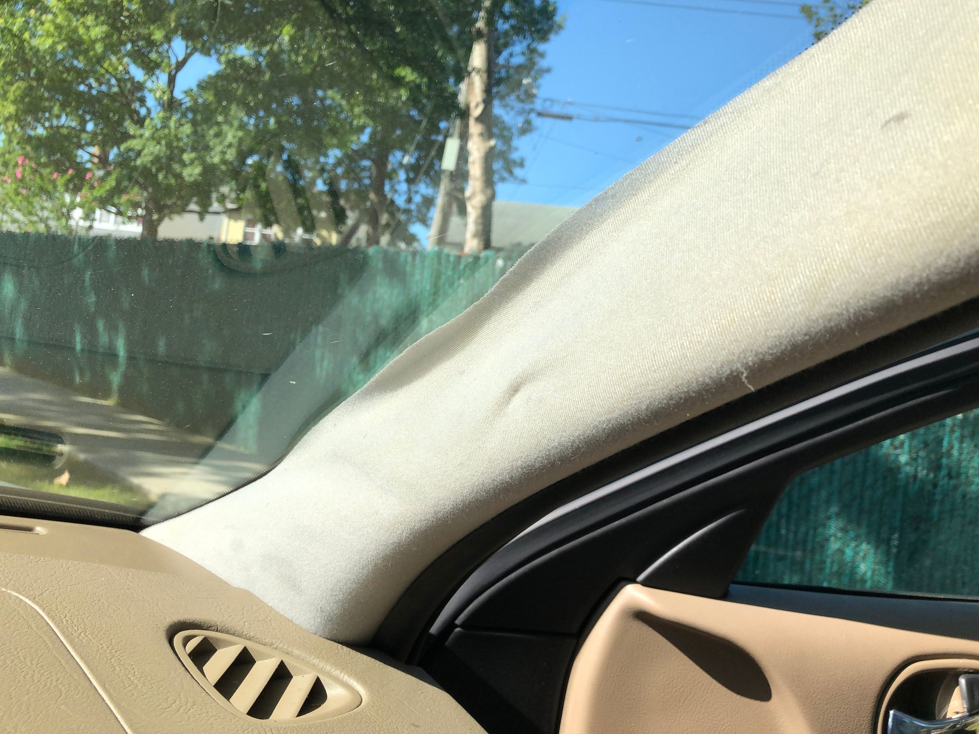

I inherited a Jaguar 2001 S-Type with only about 30k miles on it and it runs excellent, it was left sitting in a friends yard for a few years. Got everything checked out fluids replaced and I plan on keeping it until it dies. Body is in great condition. Some trim issues internally. I didn't know when I could get replacement for these. 1 - The inside door rubber trim has been stretched and hangs loose (they had some children) see attached picture, does anyone know where to get these and the clips to snap it into place? Also the front fabric covering the side pillar was loose or off when it was given to me, any ideas of how to fix this. Thanks

The rubber trim does not have clips ...it is held by the trim channel to door by spring tension of the seal...you can pull it off.....the pillar also pulls off of it's clips...if it has an airbag there, it will have a tether ...source parts from jagbits....sng barrett or jaguarclassicparts.com
