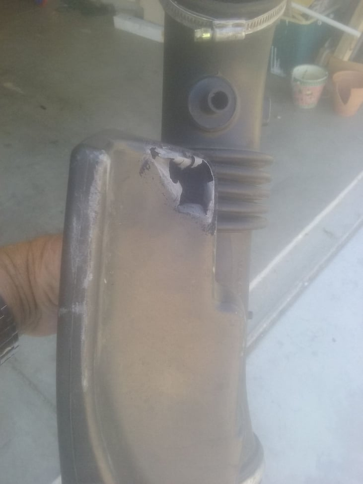

Also, remove the intake between the MAF and the throttle body and check to see if the somewhat rectangular shaped resonator chamber is intact; these can become brittle and break at the bottom corners, which cannot be readily seen without removal. This damaged portion of the airway and resultant air leak caused a forum member immeasurable grief a few years ago.
See posts #32 and #36 in this long thread:
https://www.jaguarforums.com/forum/s...2/#post1934812
