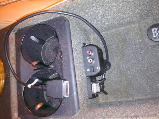

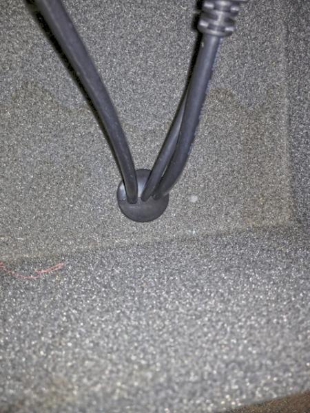

Received the package yesterday, installed it last night. At first I'm thinking there's too many wires! But it was pretty straight-forward. The fiber optic cable is even labeled on all ends.
So far it works great. My iPhone 4s works with it just fine without needing any firmware updates to the ACM. Controls on my iPhone also work while it's plugged in (with pandora). I don't have any music on it yet so I couldn't test the playlists. It also charges the phone and the USB appears to charge my phone too if I plug it into it (but you can't get playback that way).
Attached Thumbnails Just purchased the ACM-contents.jpg   Just purchased the ACM-wires.jpg   Just purchased the ACM-installed.jpg

This is an interesting comparison with the one on my car. It came already installed.
I have no visible USB port. When I took the center console out I could not find the box as whoever installed it did not place it where the instructions suggest. I didn't want to take anymore of the interior apart at that time. So it is possible that they just left the USB connector off? Without that there's no possibility of a firmware update.
I'm using the aux-in port with my Sansa Fuze and that allows me to play FLAC format recordings which are better than MP3 and I can have one format for my library.
When I did try it out with an Iphone about a year and a half ago it would not allow any control from the Iphone. It was all done by simulating a CD which is crap.
But you're describing something very different I think?

Jaguar of Greenville (formerly Nalley Jaguar) can order one for you - - I just ordered one last Friday
When I called them, they wanted over $500, and that was with our forum discount. Plus, he told me their on backorder and the one they show in stock nobody could locate and it was probably leftover from the old inventory when they were bought out this past June (by Hennessey I believe)
If they did leave the USB off of yours, as long as the ACM box itself is still the same as mine, all it really is is a USB extension cable. The connection on the box itself is just a standard USB port that it plugs in to. Everything else uses a proprietary cable, even the ipod. You have any pics? What does yours look like?
It still mimics the CDC. When I listen to Pandora from the phone it simply shows as CD 6 playing on the screen. I'm going to try a USB stick today and my older iphone (which has music on it). It states it'll play MP3 and OGG from the usb, but I don't think it'll do FLAC.
