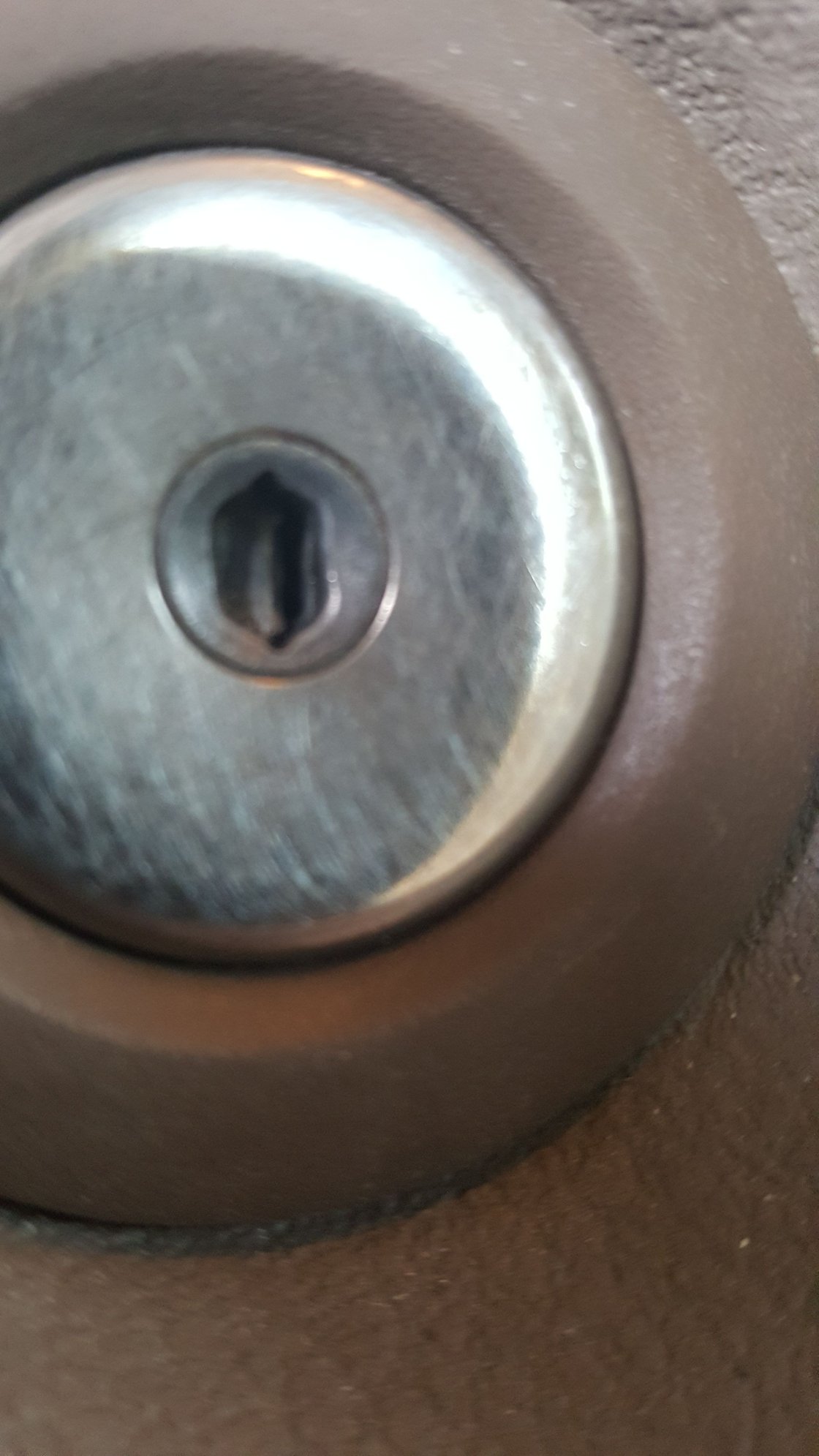

Old Oct 15, 2019 | 11:46 AM
jingo09's Avatar
Joined: Oct 2019
Posts: 8
Originally Posted by S-Type Owner
#5 refers to the sliding tab that covers the tumblers in the ignition switch lock. The sliding piece, or tab, sometimes sticks open after the key a removed; this causes issues as some modules do not power down and "go to sleep" as they are programmed to do.
here is a picture

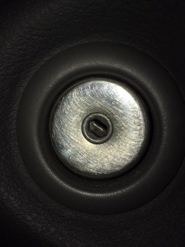

S-Type Owner's Avatar
Joined: Feb 2018
Posts: 1,797
Likes: 684
From: The wilds of Montana
Jingo09: My 2003 Ignition lock showing the tab covering the tumblers...
Old Oct 16, 2019 | 01:00 AM
jingo09's Avatar
Joined: Oct 2019
Posts: 8
im not sure what i suppose to see, from the picture i sent it looks okay or need to fix?
Old Oct 16, 2019 | 02:50 AM
M-e-l-l-o-w's Avatar
Joined: Apr 2015
Posts: 643
Likes: 278
From: Essex UK
Regarding the hole where the key goes in:
You should not be able to see down the hole. There should be a cover/flap in the hole when the key is removed.
If you can see down the hole the cover is not closing as it should and this will cause issues with the locking as the various moduels will act as if there was a key inserted.
It looks to me, from your photo that this could well be your problem. The cover/flap is not closing in the key hole.
This is a known issue.
The security system on the car is set up so that when there is a key in the ingition the remote locking and unlocking does not work.
Put a cover of some type on the carpet under the lock and then spray some WD-40 in the hole then work the key in and out. Hopefully the flap should start working again.
However WD-40 is not ideal for use in locks as it attracts dust and dirt and you may well end up doing the same job again at a later date, so perhaps some 'silicone dry spray' would be better? This dries out leaving a thin coating of silicone that does not attract the dust and dirt.
Mellow
