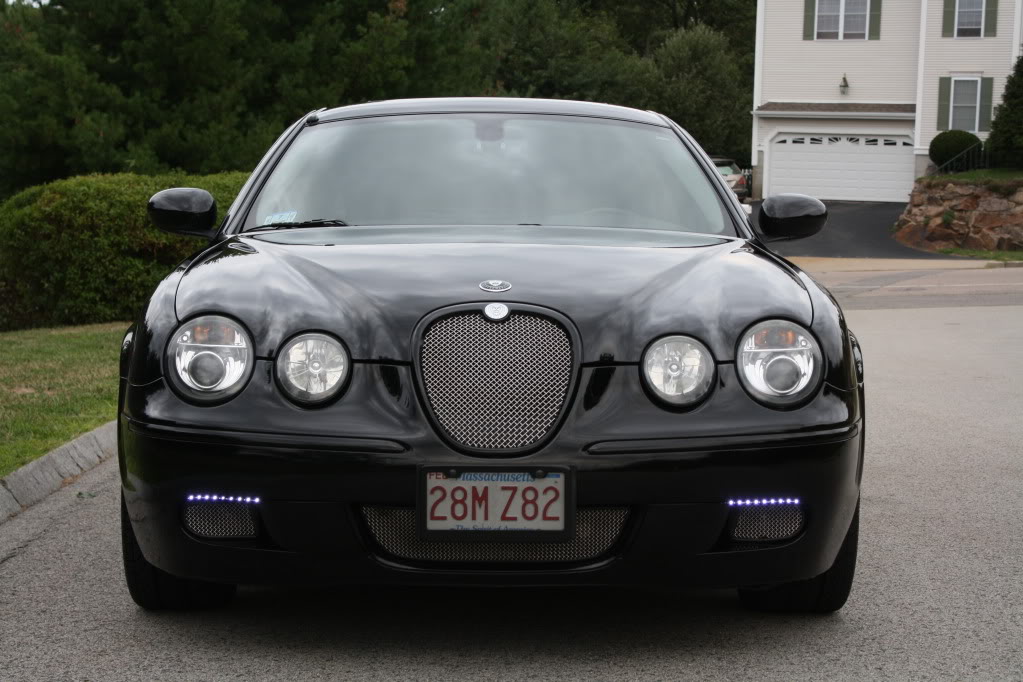

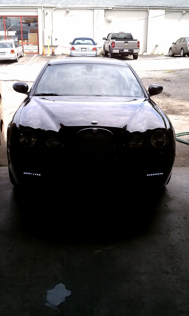

Installed them today, each strip comes with 3m backing tape, completely unnoticible unless they are on. I opted to use high quality 3M automotive tape (same stuff we use on badges) so they would be more durable. The tape that comes on there is too thin and not tacky enough. The LED's are encapsulated in hard silicone and are waterproof. They are white but give off a "pure white" apprearance, matches the factory HID's pretty well.
Tied it into the ignition and also put a toggle switch underneath the steering column in a hole I found, just in case I need to turn them off. So basically they come on automatically when I start the car for day time running lights, but if I am parked or just want to turn them off, I left myself that option. They are bright during the day and have yet to see them at dusk or at night, but I am assuming they will look pretty damn nice. I opted to put them over the fog light cutouts for more of a factory look. Almost went all the way to where the middle grill starts, but nixed that idea. Sorry for the pics, camera phone, they look ALOT better in person but you get the idea. They are subtle enough to be factory (if noone knew), but there are enough on there to make a big difference.

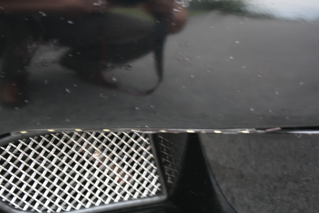

Can you get a close up of one of them to see the fit in the bumper?

You can cut the strips to the length you want, however, it has to be in 3's. So you could cut at 3,6,9,12 leds etc. They are tucked under the lip pushed to the very edge, you cannot see them when they are off unless you are bending down looking for them. In pictures they almost look like they are pushed outwards from the bumper, but in person when lit they are nicely tucked under and flush with the lines.

Old Aug 13, 2010 | 07:27 AM
androulakis's Avatar
Joined: Dec 2006
Posts: 2,964
Likes: 507
From: Hamilton, NJ
Wow,
That actually came out looking a lot nicer and cleaner than I thought it would.
Is there ignition switched + 12v under the hood? Or did you run your wires from inside the cabin.
you have a link to those strips? How long are they before you cut them down?
George

Old Aug 14, 2010 | 04:02 AM
JagV8's Avatar
Posts: 27,562
Likes: 4,930
From: Yorkshire, England
There looks to be less brightness around the middle of the right hand one. Dirt or what?
