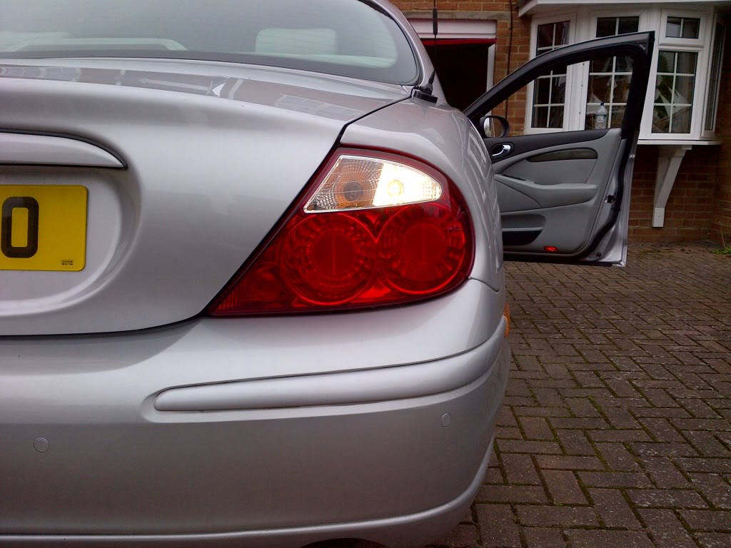

The start of fitting LED's!!!
First Delivery. Side lights, reverse lights and Front Spot Lamps. Oh and an XF style Leaper

Reverse Lamp Before
Reverse Lamp After

I have another couple of sets of LEDs on there way to me. One set for the Registration Plate lights, the rest for the interior lighting.
All the LED's fitted are canbus compatible so have no issue with them staying slightly illuminated after they have been turned off, nor do i get any dash errors.

The ones in the front fogs are specific low light output leds, still controlled by the fog light switch inside the car. From what i have read on line and in the VOSA guidelines, I have come to the conclusion myself that they are now the intensity of aditional driving lights as the dazzle intensity is less than standard 55w output bulbs. I may be wrong, so i'm going to get an MOT tester mate to verify for me. After all, the police use the same written guidelines as VOSA.
The sidelight bulbs (top corner of the headlight) are 'canbus' compatible, so they won't stay dim for a while after they have been turned off. I have tried non 'canbus' bulbs that have stayed on like you described Rasputin. The one's i got are from Amazon and were very reasonably priced. All of the LED's i have are 'canbus' compatible. You can get the same effect by wiring a resister in-line a normal LED. But, unfortunatley you would have to seek help and guidance from someone that knows about resisters because i haven't got a clue - thats why i went for the easy option
