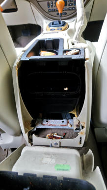

@HeadmasterAutomotive if you find someone who sales or can find the same part, please let me know. I have the same problem, driver an passenger side lower part of the center console, and the worst part is that this part also is the support for the center arm rest and rear air vent, those supports are also broken. I really need to find that part but the color of mine is Ivory.
Side view from driver side
Rear view, arm rest and rear vent support broken, this is why I need both sides

I just looked at Driver side photo. That can be repaired in place and not deteriorate any further. Glue.....It takes super glue, but not some junk. BSI (Bob Smith Industries) makes a kit. three different thickness bottles and remover. This glue is used in instrument repair. The super thin will penetrate the crack and stabilize it. Then you can make some minor fills and spray it if you like. I have the same car and fixed mine.

Thats sound like a great idea. I will follow up with this. Interested in the fact it can be done without removing the lower console. I'm always worried about causing more damage with removing something like this and making a decently fair job into a bigger "headachy" one.

The Photo i post is old, that part doesn't exist any more, it broke completely in much small pieces, both sides. need to find one in good condition.
