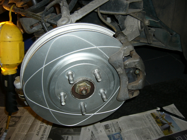

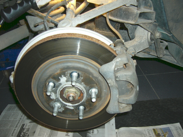

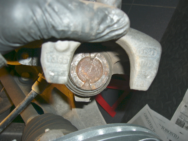

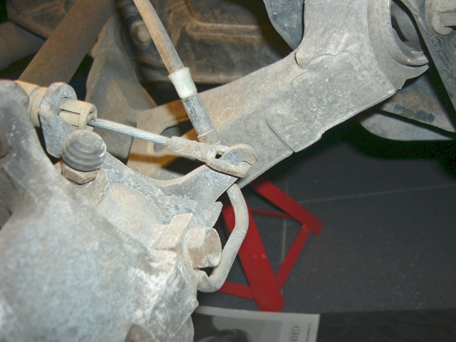

I finally got tired of cleaning my wheels due excessive brake dust.I decided to go with Akebono ceramic pads and ATE grooved rear rotors.Because my front rotors (by Jaguar) were in good condition I decide too stick with them for now.
No problems installing them.I have attached some pics for anyone interested.

Well I have about 400 miles on the new brakes.I am really happy with them--quiet clean and effective.The initial bite is a little less than standard pads,but on full brake I cannot feel any differencein stopping power.
These pads do produce a little dust,but it mostly blows away and what does not is light coloured.End result is my wheels look clean.
I should note that the grooved disc do not produce any more noise than regular rotors.
