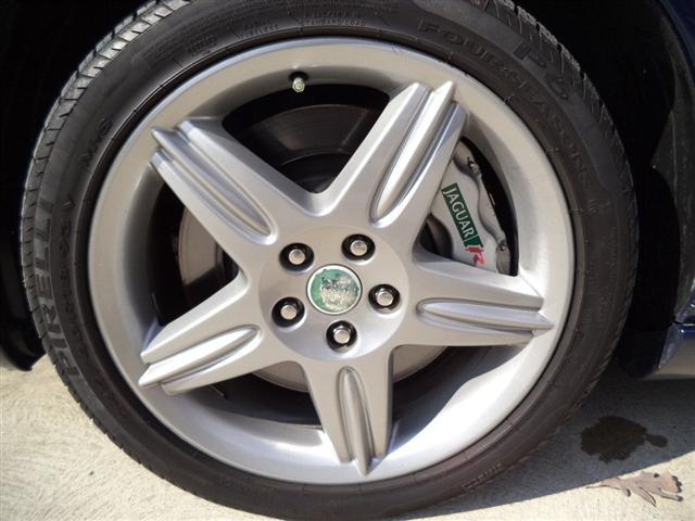

Took My Baby In For A Fluid Change And They Didn't Latch The Hood..And Drove Way To Fast..
All Wheels Same Condition Zero Curb Rash. Unsure Of Price As Of Now..Open To Offers. Will Take More Pics If Needed.
