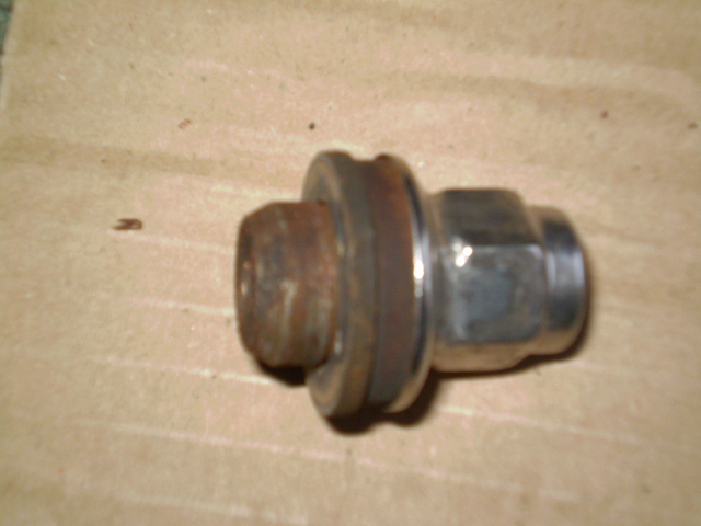

Originally Posted by JOsworth
SNut, slip-over cover, metal washer backed by a nylon washer....
I'll go look again but nylon washers? Doesn't even make sense. Who puts 80-90 ft lbs on a nylon washer and expects proper results?
OK I just checked. No Nylon washers. That must be a "drag" option ...
Old Apr 11, 2011 | 07:59 AM
  #39
JOsworth's Avatar
Joined: Jan 2009
Posts: 3,390
Likes: 195
From: Akron, Ohio USA
Hmmm... Wonder if the R has different nuts... I know it's got more *****...
Ooops... I'm gonna get banned......
Here is a picture of the factory lug nut that was on my 05 3.0. Notice the black nylon washer between the metal one and the shoulder of the lug nut...

Likes: 195
Default NOT Acorn Lugs....
Umm, don't get Acorn style lug nuts... They are not correct.. Acorn nuts are capped (closed top) with a taper seat.. The Jaguar lug nuts are mag type / sometimes called "shoulder" or "washer seat".. Please see the chart below.
