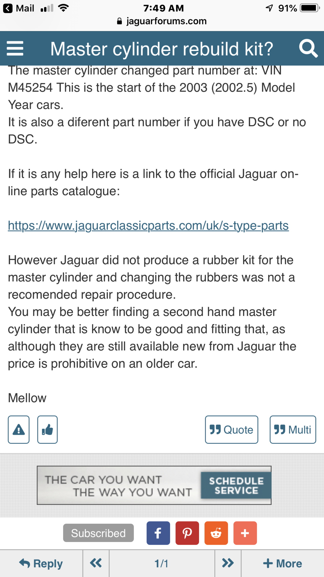

If it is any help here is a link to the official Jaguar on-line parts catalogue:
https://www.jaguarclassicparts.com/uk/s-type-parts
However Jaguar did not produce a rubber kit for the master cylinder and changing the rubbers was not a recomended repair procedure.
You may be better finding a second hand master cylinder that is know to be good and fitting that, as although they are still available new from Jaguar the price is prohibitive on an older car.

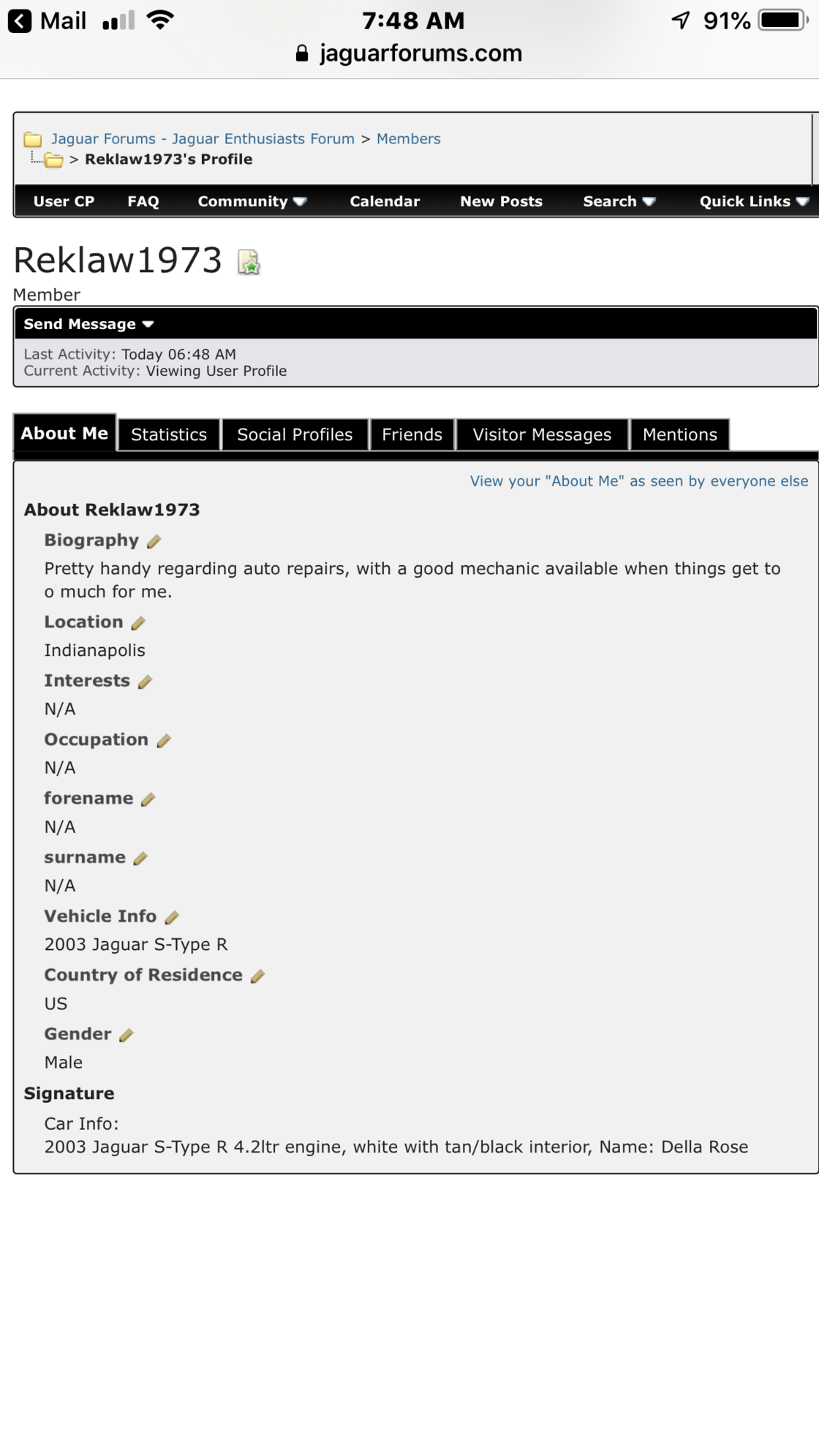

Regarding the signature, thanks for the vin info. I am not sure why it isn’t displaying.
Here is a screen shot on my profile info:
As you can see, I have a signature with my car info. I realize how helpful
that can be.

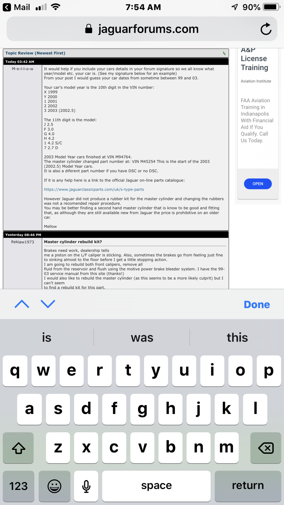

I should also note that Your posts do not seem to show a signature with your car info:
Mobile page
After requesting desktop
Perhaps there is a setting somewhere, I’m not sure.
