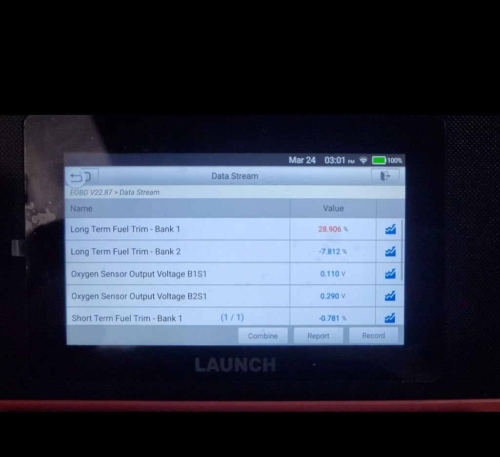

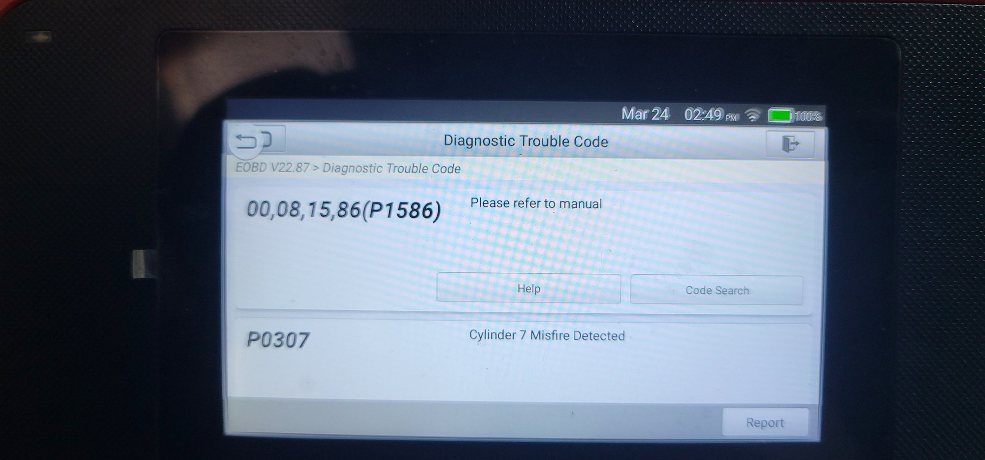

so I just tried the pull a Coil while running and see what happens. Here's the results. All the driver side while running will not at all change the engine it runs the same as if I did nothing still rough.
Passenger side every single plug I pull will make it drop idle and run even worse. I plug it in and back to before. Soooo why would the entire driver side do nothing and pass side will infact mess with idle? Really wondering now.
Thanks guys I'm just throwing info as I can. I just wanna get this baby going.
This is idle.
This is reving to around 2500 rpm
Codes that came this time
