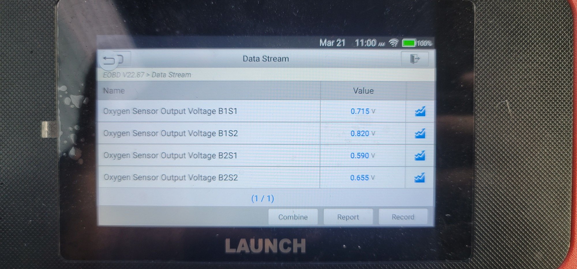

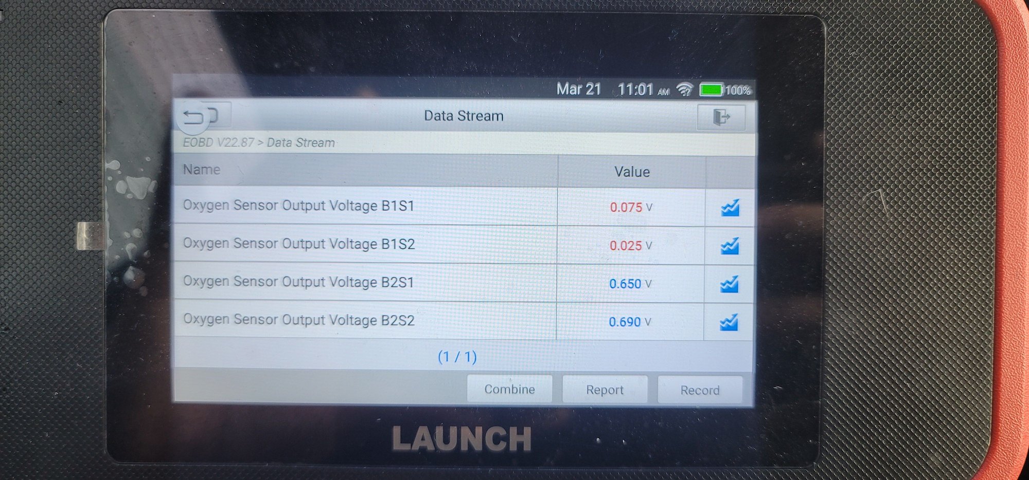

Yhis is whe. Giving a small bit of gas pedal
Idling
here some photos of her running. Anyone make anything of this?

You need to watch a graph if you're going to look at the voltages.
The trims look awful but did you do them in the way so often described?

So I just started the jag for a first cold start for them. There is two with idling and the one I gave it a little gas a d held it for a sec. Im really praying it's a injector. They will be here tomorrow and I'll change it out and report back asap. Thank you kind people.
