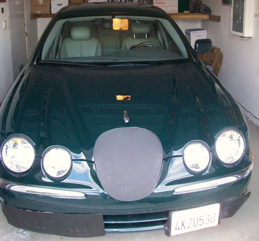

Modifications that have a proven positive impact are aerodynamic modications and reducing weight. Aero mods: lowering the vehicle, grille blocking, passenger mirror removal, full belly pans. These changes work best at higher speeds but do make a noticeable difference. Weight reduction is less noticeable but still has a positive effect.
I am somewhat of a fuel efficiency buff and keep fuel logs for all my vehicles. I have achieved a best tank average of over 36 MPG and have a lifetime average of over 27 MPG in my 2000 S Type 3L SE. The mods I have done are 42 PSI tires, Grille blocking over the uppergrille opening and about 1/2 of the lower grille openings, R side mirror removal, front wheel deflectors and keeping unneeded stuff out of the trunk. I'll probably add a streamlining panel under the engine to further smooth air flow under the car. I made all my aero mods and they are easily removed if I need more radiator cooling airflow or need to use my foglights.
Some people will disagree with my efforts which is fine, I have a thick skin. The S Type is a great car; beautiful, fast, luxurious and efficient. I hope to enhance the efficiency without degrading its other qualities. This is what has worked for me. If you drive smart, keep your tire pressures up, and keep your car well-mainbtained, sleek and light you will be rewarded with good fuel economy. I hope you find my suggestions to be helpful. Please let me know if you want more information on getting the most fuel ecionomy out of your Jag.
