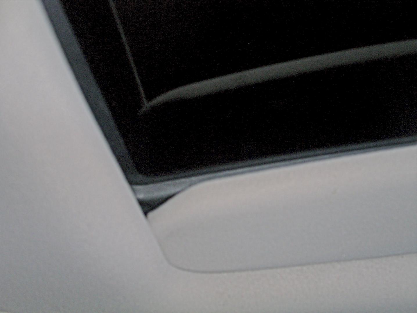

Attached is a photo of the rear of the sunrooof, glass panel closed, sunshade opened as far as it will go. No screw heads are visible/accessible. What should I be looking at?

Ok, let me get a pic later, but your not quite looking in the right area.. You need to get your head up to the moonroof and look along the outside edges of the moonroof from inside, there is a rubber accordian looking deflector that you need to pop off. Then look between the headliner and the glass roof along the outside (above the oh crap handles) on each corner, there are the screws.

That's so funny ... I'll wait for your pic! I don't think I have any "crap handles"
