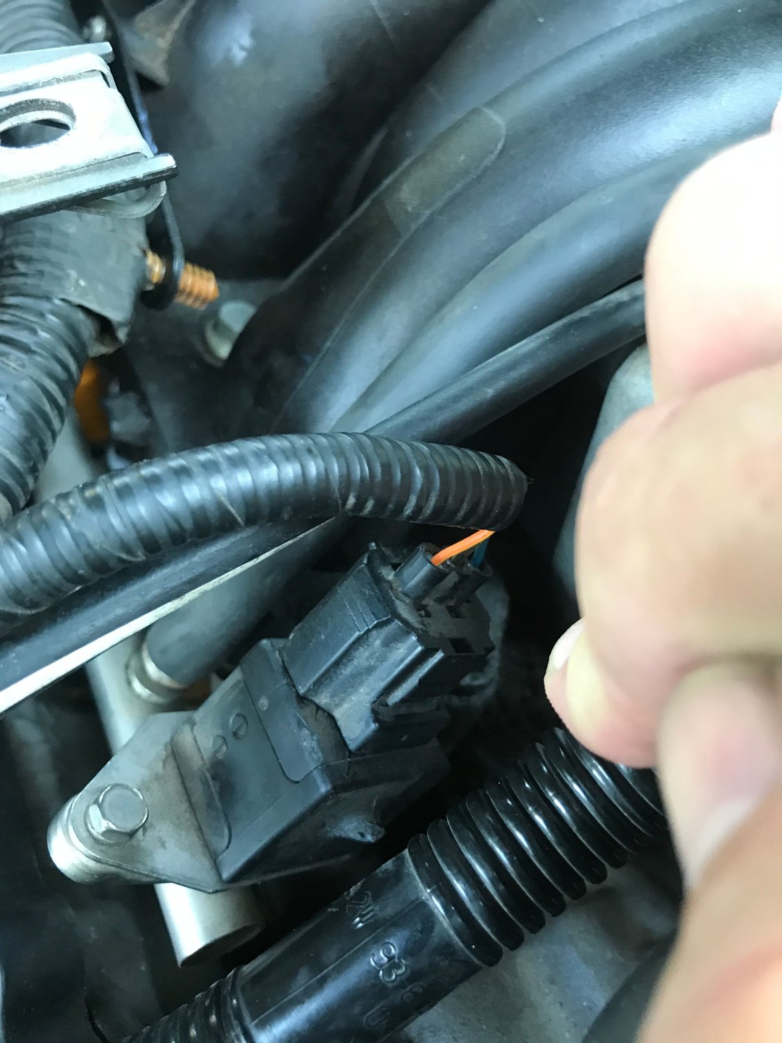

Changed injector, success . But (there is always a but), I broke the vacuum line off the little black electric thingy at the front of the injector rail. What is this thing called? Will have to order a new one.
Thanks

I think it's the fuel pressure sensor. On my STR it was about $95.
It should set a code but drive OK because there is a factory default setting if the sensor fails.
What's the car doing?

"we have liftoff"
Received part from Advance Auto in mail. Put it on. Run runs correctly again.
Thanks for all your help.
Brian
