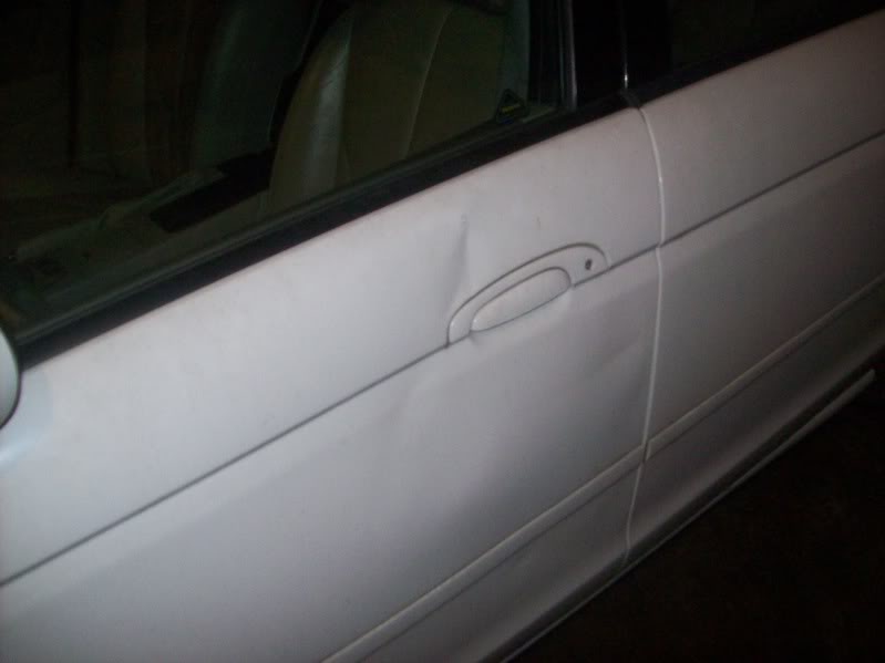

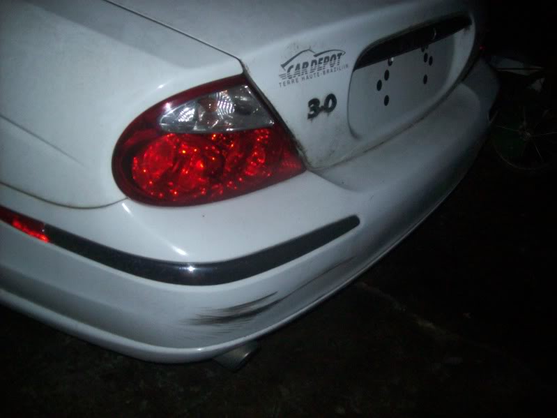

Sat for 1 1/2 years. Needs the following: oil pan, front & rear bumper needs sanded and repainted, driver's side fender has damage and will need replaced and painted, needs a dent pulled out of driver's door.

Here are some more pics that show the damage:

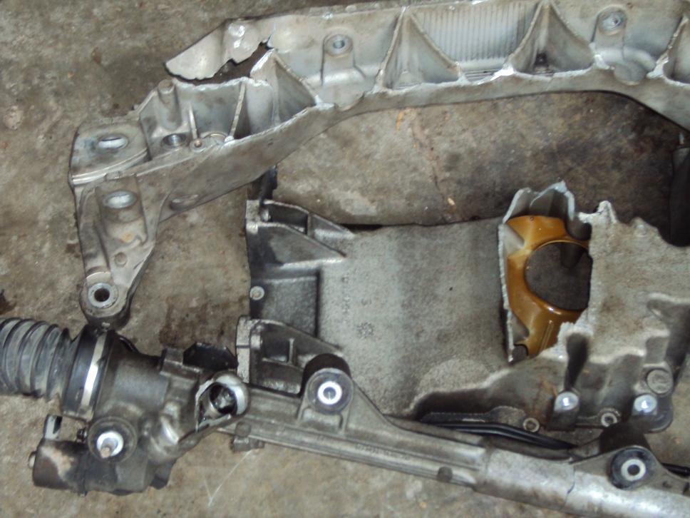

Exclamation bit of bad news...
Well, it seems I have bitten off more than I thought I would have to chew here.
To answer Translator's question, I will let the pictures show you before I rattle on:
as you can also see on the attachment jpg of the Rack & Pinion it is cracked as well. Now this part I keep calling "subframe" is what the R&P is bolted into. It also has 2 motor mounts on it. Can anyone tell me if i will have to lift the engine or support it to change this part?
I only ask because I still can't get the JTIS manual to work right.
See thread-->https://www.jaguarforums.com/forum/s...ghlight=jagman
THanks for listening and participating!!!
Attached Thumbnails New JAG owner here!!! 2000 S-Type: Opinions Please!-oil-pan-layout.jpg   New JAG owner here!!! 2000 S-Type: Opinions Please!-rack-pinion.jpg

You should be able to lift the engine with a jack and put something like this
which you can custom make yourself. It will hold the engine from the top while you drop the subframe and replace it and replace your R&P.
Heres a home built one.

I came to the same conclusion about the support beam. Found one at a local retailer on sale for only $50!!! I'm going to pick one up this weekend as well as a new battery to drop in there so I can re-pull any codes with my OBDII scanner.
DOES ANYONE WITH ACCESS TO THE JTIS KNOW WHERE THE CORRECT ANCHOR POINTS ON THE ENGINE WILL BE?

So I got the oil pan, cross member and r n' p taken off this weekend. Wasn't as bad as what I thought it would be. Most of the bolts and nuts are metric size and not a lot of switching back n forth.
Here's a shot of the 3 damaged pieces:
And here's a shot of the underbelly of the engine block:
You can see I left the air compressor {top-left side of pic} & Altenator {right side of pic behind the exhaust} attached and was still able to drop the oil pan!!!! There were only 2 bolts on the bottom of each unit that I had to undo and then just loosened the top ones [1 for the altenator and 2 for the compressor]
And my engine support is working just fine so far!!
Now the best part is I now have access to alldata pro!!!!!
Can't wait to get home and figure it out!!!!
