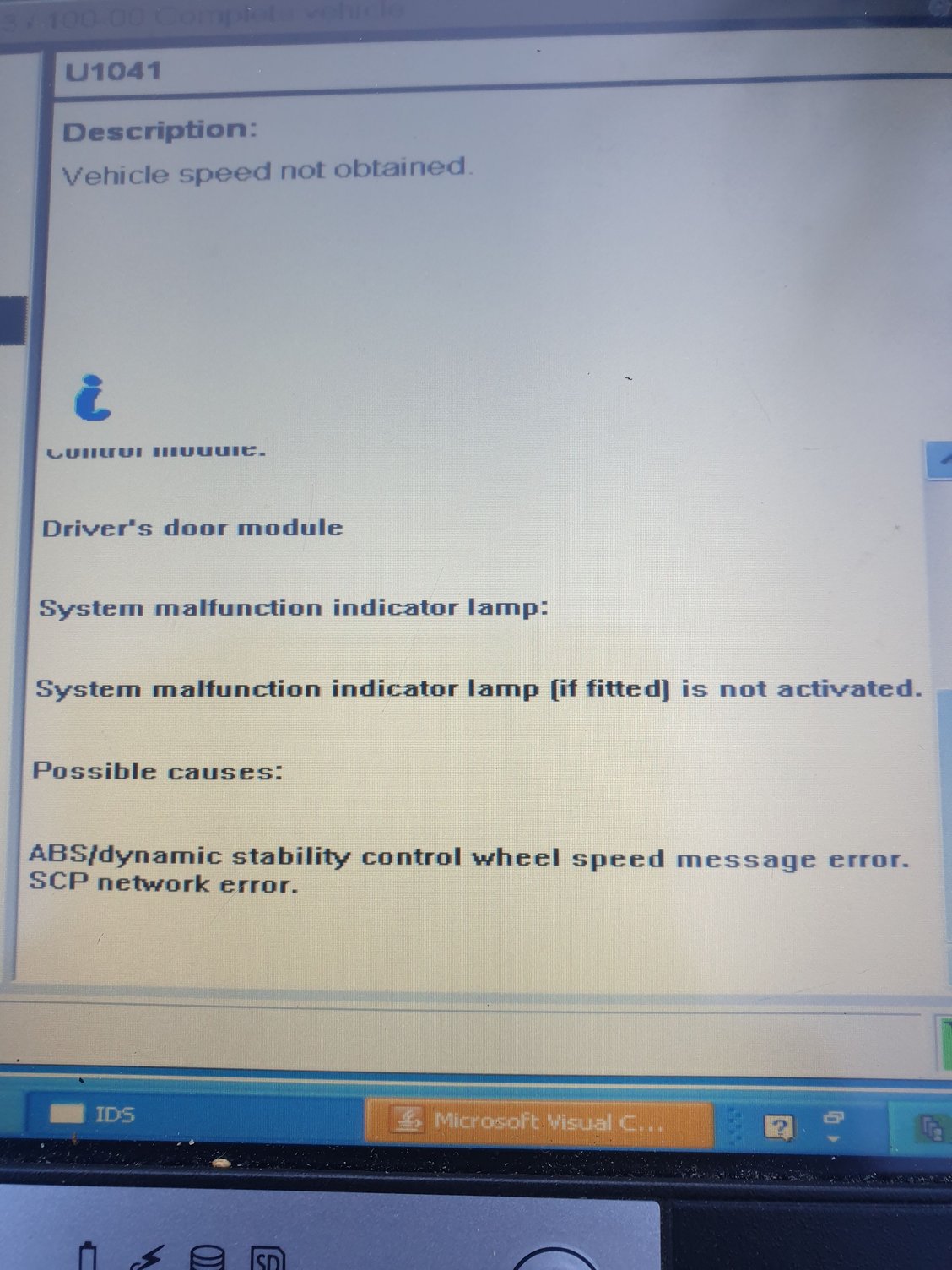

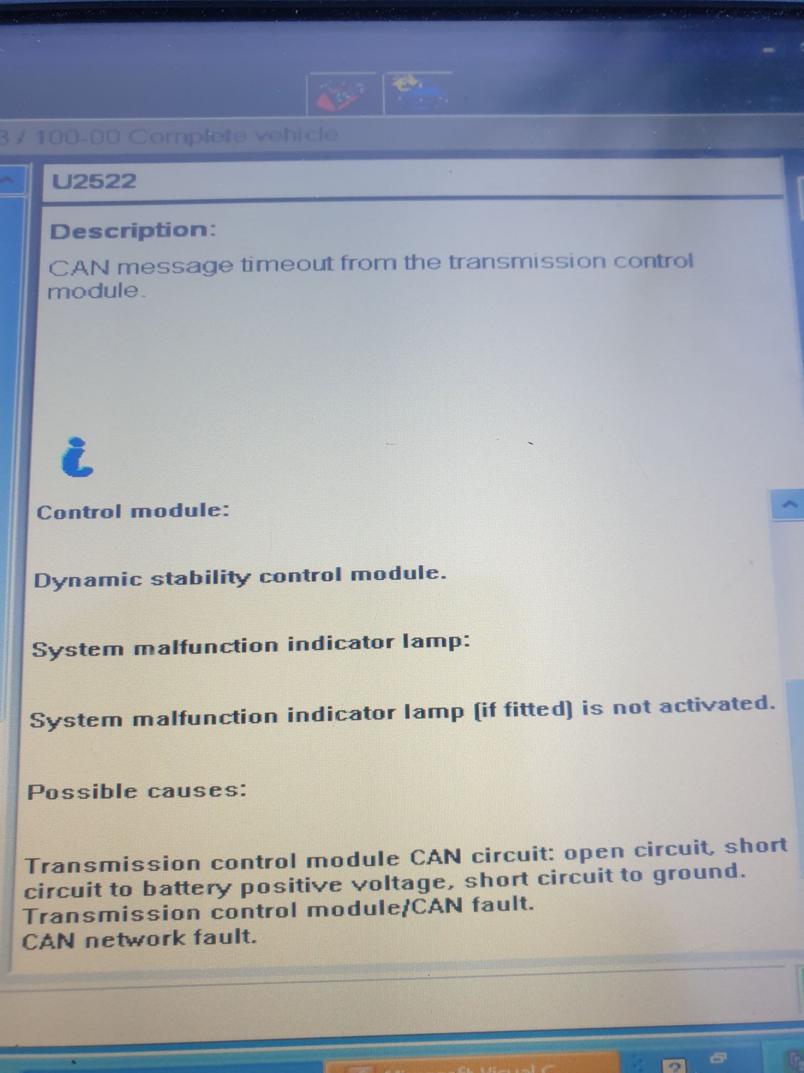

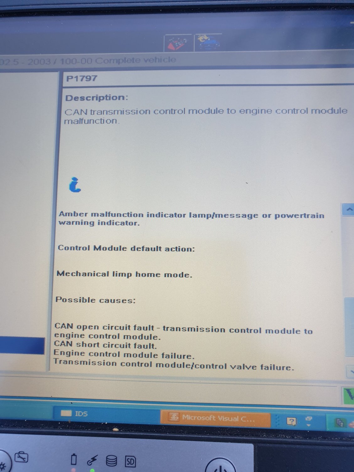

Hi and a big thanks to all those offering help
spent a bit of time on car today
will do this in two separate posts
This is for the fault codes
Also read some fault codes from JLR IDS
Most to do with instrument cluster and can bus network
My next post is can bus test i did
So bit confused as some of fault say short circuit to ground or open circuit
Even tried to clear codes but that not happen still there
