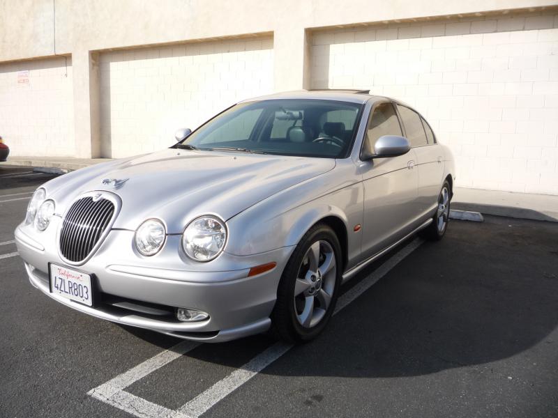

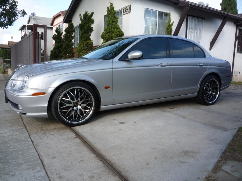

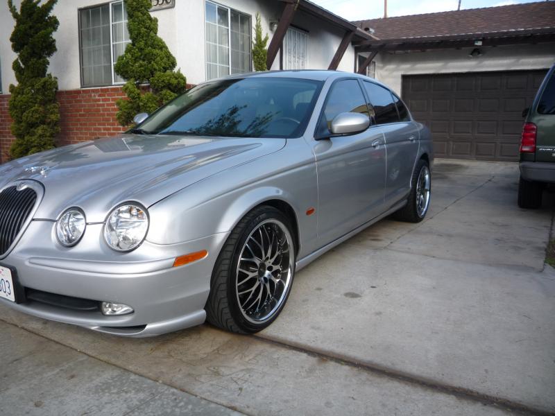

thx ahead for the advice and here are some before and after pics of the new shoes!
Attached Thumbnails newbie with a few questions on my new toy!-silver-whips-022.jpg   newbie with a few questions on my new toy!-silver-whips-023.jpg   newbie with a few questions on my new toy!-silver-whips-025.jpg

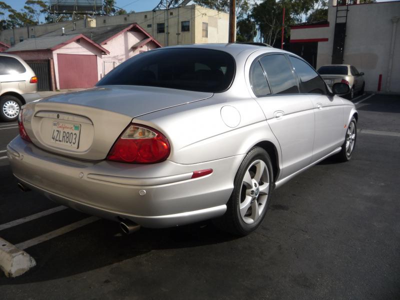

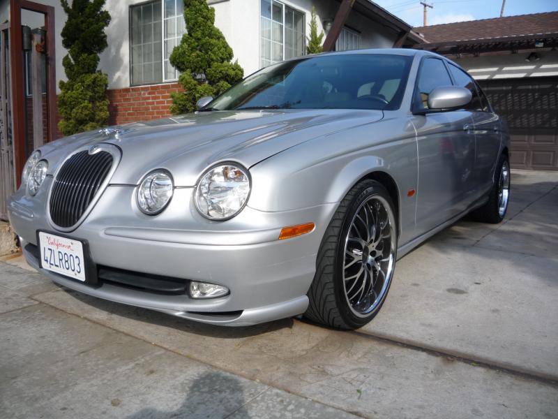

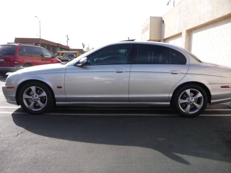

here are the new shoes
Attached Thumbnails newbie with a few questions on my new toy!-silver-whips-033.jpg   newbie with a few questions on my new toy!-silver-whips-036.jpg   newbie with a few questions on my new toy!-silver-whips-034.jpg   newbie with a few questions on my new toy!-silver-whips-031.jpg   newbie with a few questions on my new toy!-silver-whips-032.jpg
