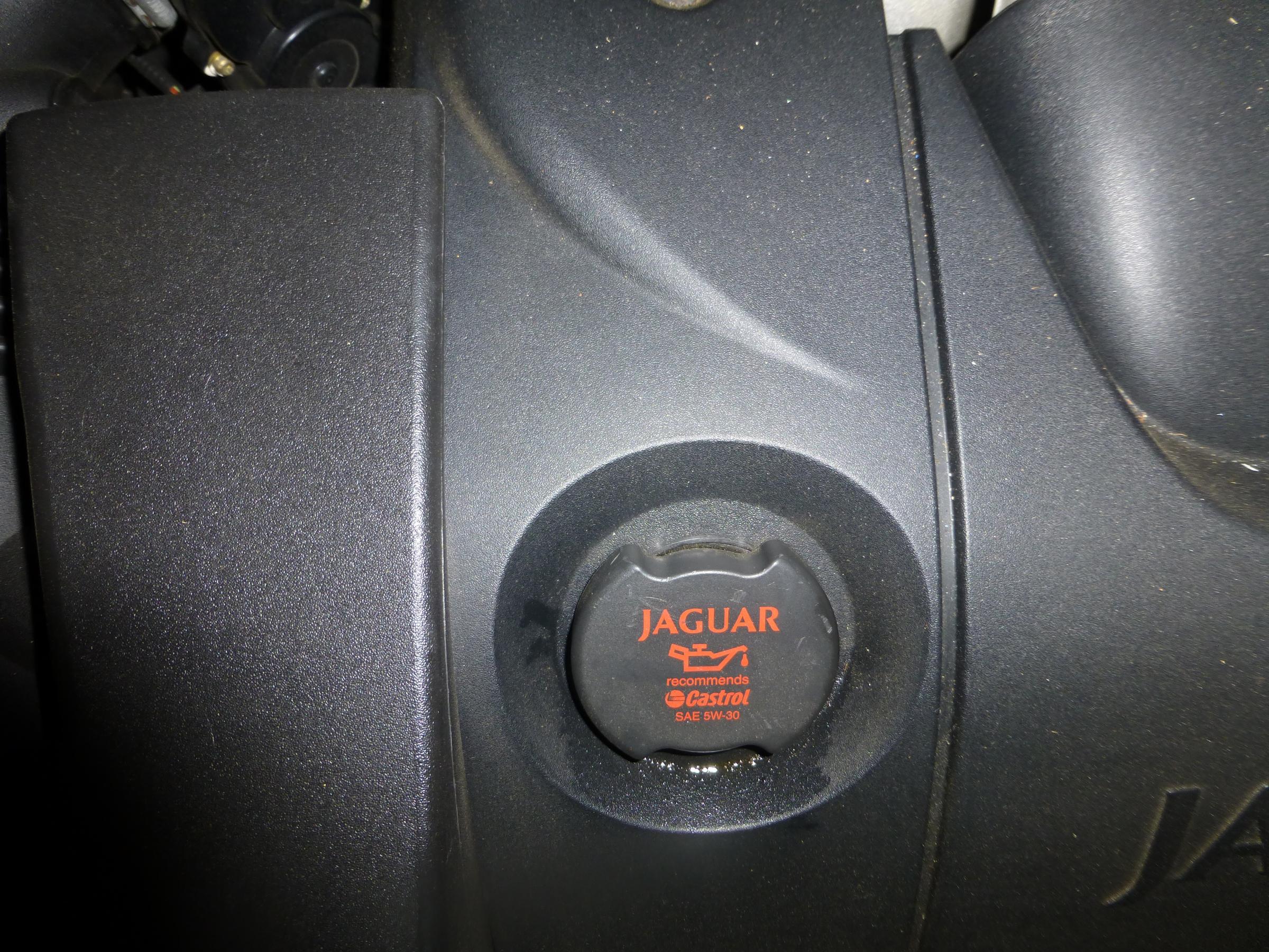

On the topic of oil, is castrol gtx the prefered oil for these cars? a lot of my German cars love mobil 1.
Old Nov 11, 2014 | 11:27 PM
  #37
joycesjag's Avatar
Joined: Feb 2009
Posts: 8,020
Likes: 1,731
From: Sunny South Carolina
Your oil cap under the hood should even state "Castrol 5W 30"

Old Nov 12, 2014 | 07:44 PM
  #40
joycesjag's Avatar
Joined: Feb 2009
Posts: 8,020
Likes: 1,731
Originally Posted by Mikey
The Castrol people would just love to have your money, so they'd prefer that you use their oil.
The Jaguar/ Castrol relationship is purely a marketing deal, nothing in any way related to product superiority.
Below is a picture of a US market Jaguar 3.0 engine taken less than 3 minutes ago. God bless Castrol and Jaguar calibrating! Our US parts stores run bimonthly sales on Castrol conventional oil, and yes I take full advantage of the sales! I just go somewhere else to purchase my (unnamed) 710 filter !
Oh and for those that have witnessed Joyces under bonnet, sorry I haven't hosed it down for a month or two, so I apologize for the dust and 710 ring around the filler after this past weekend.
