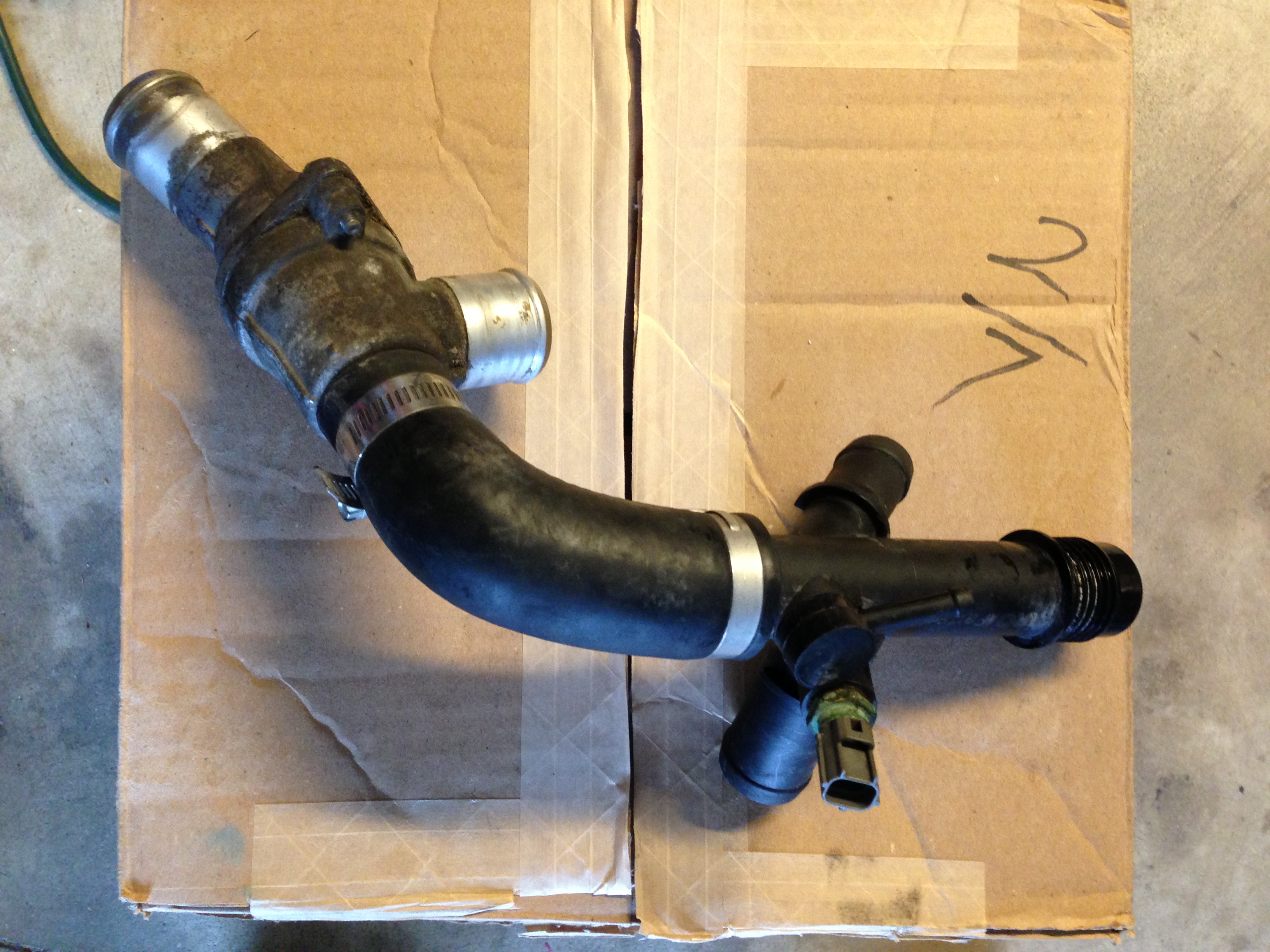

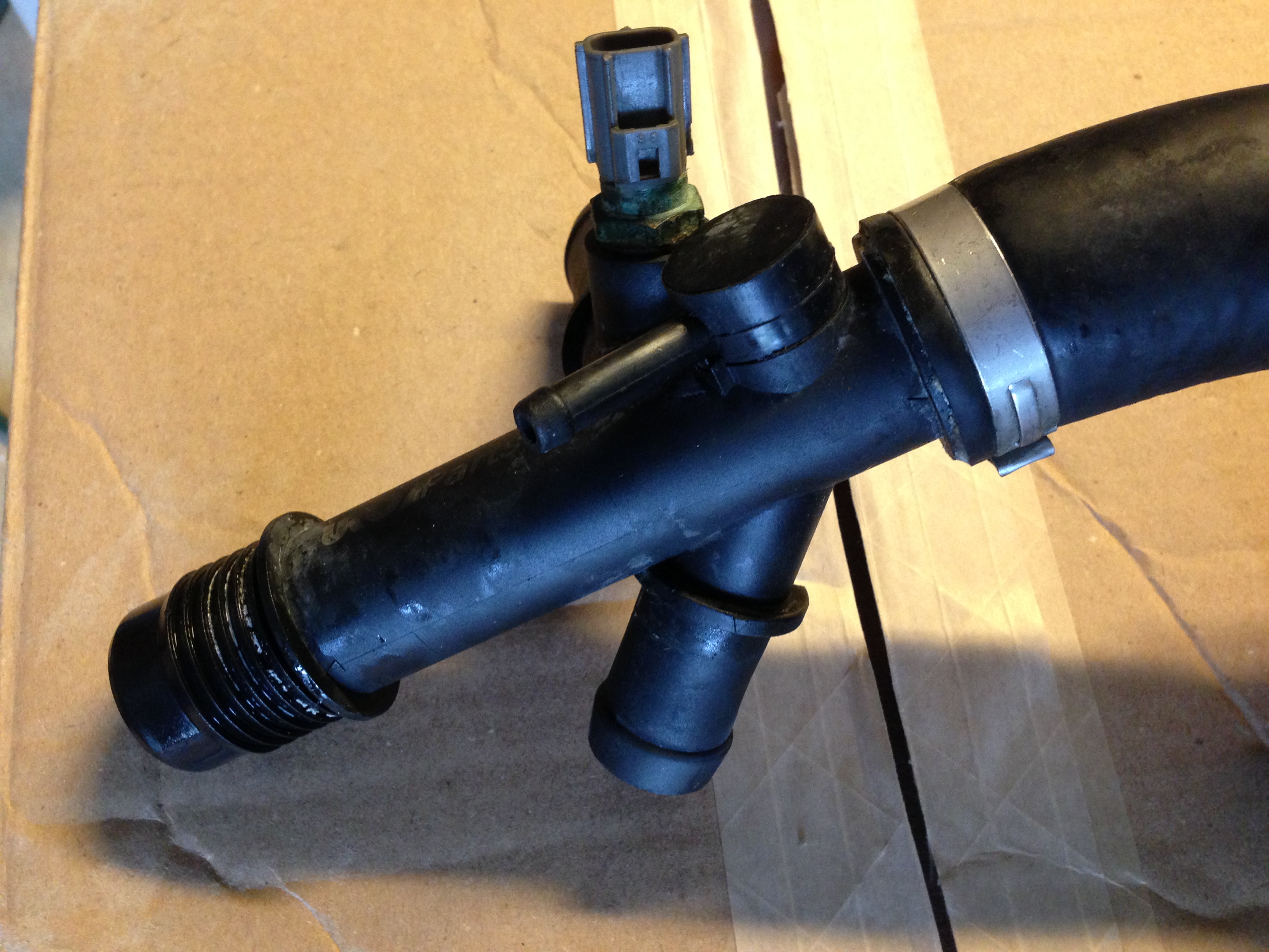

I have a 3.0L like you and have had coolant loss issue. Mine had three culprits:
1. the 'turret' on the top coolant hose broke. See picture on the left. Well known issue and the first place to check.
2. the reservoir lower nipple developed hairline crack. It leaked when pressurized. Reservoir replaced.
2. upper hose from water pump to DCCV split. This is part quality issue and remedied with better quality hose.
Attached Thumbnails Overheating - Help-img_0233.jpg   Overheating - Help-img_0232.jpg

^^ Spot-on advice from TonyX. Check all of those sources carefully (especially the reservoir nipple and the turret on the top hose) before you do anything else. The weak plastic used in these parts flat-out kills them after just a few years....
