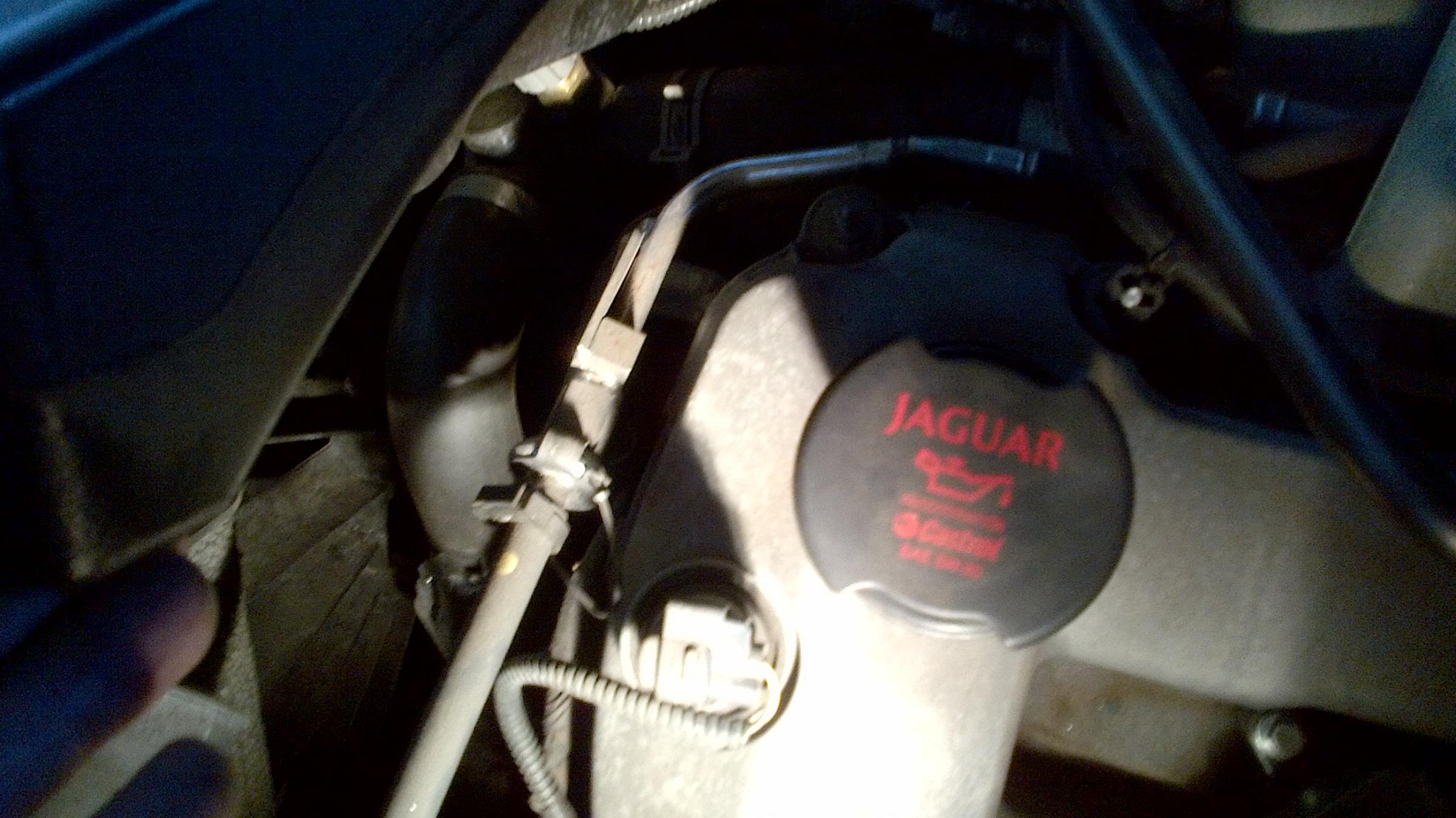

hinsonb's Avatar
Joined: Jul 2013
Posts: 15
From: Rock Hill, S.C.
Here is what I see when I look for the valve that is shown in your link. I am guessing my car doesn’t have this option. Any other ideas?

Gus's Avatar
Gus
Joined: Jul 2008
Posts: 11,356
Likes: 2,236
From: Berlin Md.
Sorry I do not have a 2005 car to look at but i thought all the 3.0 were about the same. However, I am not convinced it is a fuel problem and I was an aircraft mechanic.
