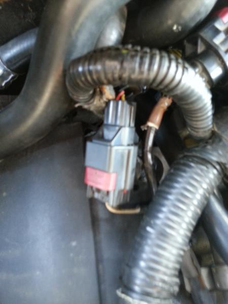

I attached 2 photos.. I believe these are the connectors for both knock sensors... If I disconnect the right side and jump it into the left side sensor will it solve the problem temporarily?

found this picture and figured out the knock sensors run toward the front not the rear... I must have been looking at the O2 sensor connectors?
I found the culprit another broken wire on the connector again. should have her fixed in 30 minutes.. woohhoo!
