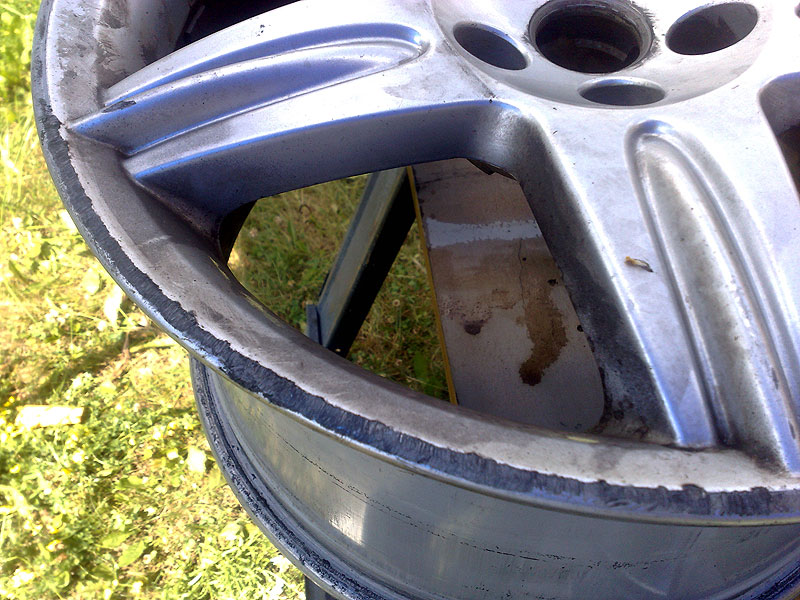

I refinished mine using automotive lacquer in a similar process as painting any body panel.
They were in very bad shape when I bought them, the pic does the talking,
After a lot of sanding and repair work, paint and clear, looked like this,
I did not like the shade of silver I painted it though, so I lightly sanded them down again, and repainted them VW/AUDI SILVER ARROW. Pictured in my signature now.
I want to go even brighter silver, so next time I have the tires off for replacement, I will respray the wheels again, this time with VW/AUDI REFLEX SILVER.

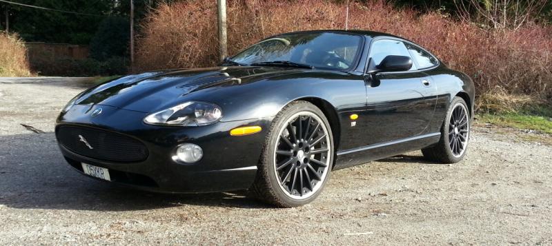

My wheels were curbed before I had the car so this is what I did.
I used a product call Endura. Its a 2 part linear polyurethane. It is used on planes boats and cement trucks. Very hard surface.
I dismantled each wheel being careful not to shear any of the bolts off as the car is from Ontario and the salt had made the bolts a little tight to get off.
I carefully tapped the spokes out from behind with a rubber mallet and marked each of the wheel parts so they went back into the respective rims when it came to reassembly.
I washed the spokes well with a degreaser and pressure washed them so they were really clean. I sanded the surfaces by hand with a fine paper to key them well for the primer.
Then my friend who does custom painting sprayed them for me. First a coat of primer and then flat black and lastly satin clear coat. This gave them the depth and the anthracite glow.
It cost me $250.00. That included the paint. Money well spent I say.
The chrome outer rings on the wheels were were not possible to remove without damaging them more than they were from the curbing they had received before I bought the car.
I purchased a plastic abrasive wheel, kinda like a wire brush but made of stiff plastic. I put the brush in a fast drill and brushed the chrome until it had a satin chrome finish. This detracted from the curbing scrapes and gave the finish that went well with the satin black spokes. I have very little chrome on my car so that was OK with me.
I then reassembled them being careful to get the right centers with the right rims, mainly in the event that they were balanced as a pair and used a compound on the bolts to prevent them corroding and torqued them evenly.
The whole process took me less than 4 hours.
Could not wait to get them on the car. So here they are.
More pix in the link below my signature...........

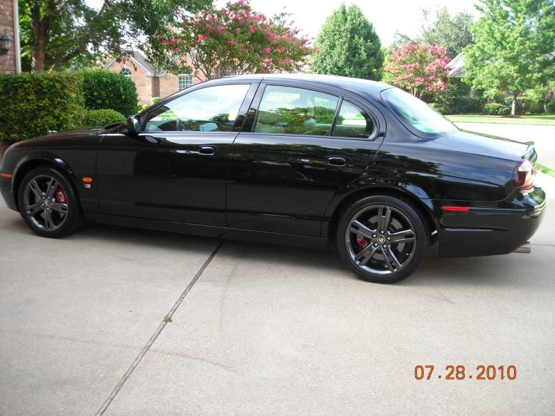

Stock rims painted gun metal black/silver by Jag Dealer $75.00 each good deal I thought
