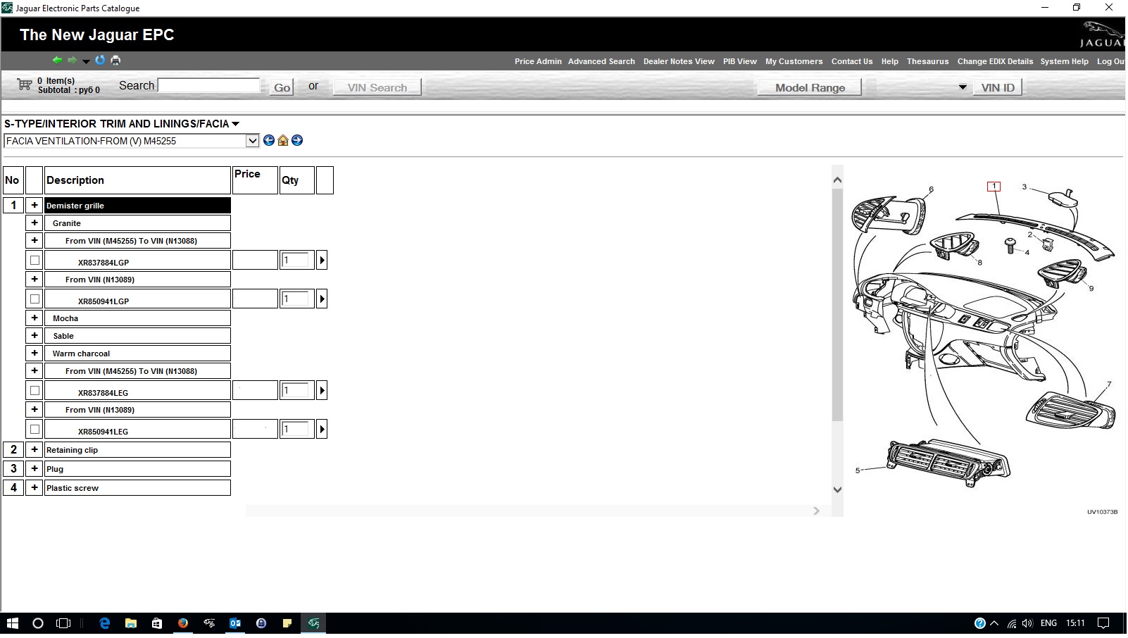

Old Mar 6, 2017 | 09:17 AM
It's the Demister Grille. P/N change at VIN N13089
Final 3 letters of the P/N are the colour code.
