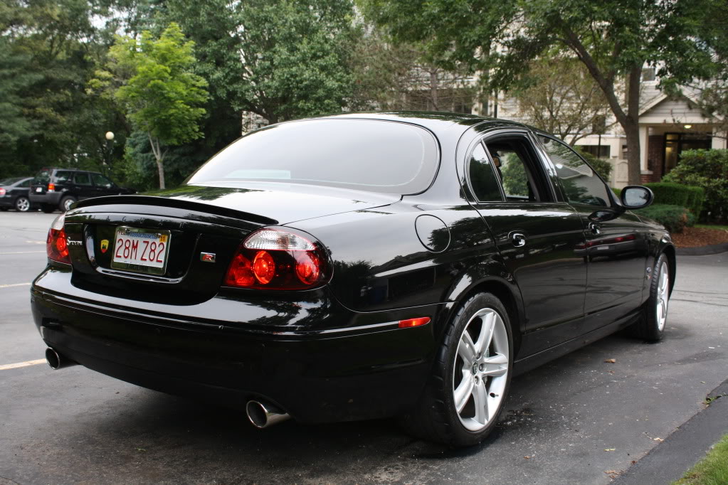

Here are some pics after installation, wasnt too bad. It actually looks ALOT better than I thought. Already have had multiple comments. If anyone is planning on getting this, let me know, there are some tricks I had to figure out.

Thanks a bunch! I dont like how the 05 and up STR's do not have fog lights. It looks as though they should be in there, and that you have a "lower" trim that doesnt come with them. The original black plastic inserts just didnt do it for me.

Ya I was confused at first so I called Mina. Just order the one made for the 05, it shows one piece on the website but you will get the 3 pieces. Let me know if ya decide to get it. Thanks for the compliment btw.

I bought he same kit but didn't end up using the side pieces (only the middle).
How did you attach the side pieces? Drill a hole?

My mobile: you need to use needle nose pliers, and pinch the mesh together on the hole that the supplied screw is supposed to go through so the screw can't pop through. Take the panel off right next to where the fog light area is and squeeze your hand around with the supplied flat bracket. Simply screw them together. Make sure the bracket covers a good amount of the existing black plastic insert. Somewhat tough to explain, let me know if that makes sense. Yes I did keep the black rubber around the mesh. Car is black and is so snug against the body that you can't see the rubber molding.
