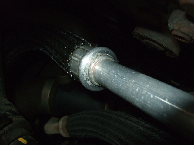

A while ago i noticed whilst having the underbelly pan off that there was about an egg cup full of oil under the vehicle. Assumed was engine oil anyway cleaned it up and continued with my job of changing the transmission fluid. That was duly accomplished and then I noted that the oil that was dripping onto the floor was now red (different ATF used) so not engine oil but ATF. Leak is coming from join on bottom hose to and from cooler at the point near the aux belt. See attached picture. Question is how easy a fix is this or am I asking for trouble trying to fix myself? Sometimes there is only a few drops other times quite a bit. And one other quick question does anybody know what the pressure in this pipe is? Thanks

I looks like it's a swaged-on fitting. Do you know where on the fitting/hose the leak is originating?
Probably a new hose assembly is needed. Everything is so torturously located in modern cars that I expect getting one made is going to be pretty difficult but you might be able to get a hose shop to make one up using the old fittings.

Yes it is a swaged on fitting. You can possibly discern where it is leaking by the feint pink line running around the fitting. Its coming from where the pipe enters the fitting. I agree these things should last a lifetime, but they don't. At work we are always having to get such fittings remade. I am unsure what is under the braided portion. First thing that struck me was to cut the pipe and put some other sort of fitting on. It in some way depends on the pressure it is operating at. I am also led to believe that to replace will not be the easiest as its the lower one, the upper one can be got at with the bonnet, sorry hood, up. Also believe both flow and return are connected to a plate that fastens up to the transmission pan.
If anybody can hazard a guess as to what pressure the line is under I can go from there. I can get hoses made up through work and may go down this line, just accessing the lower hose/cooler connection will be the bummer.

The hose assembly must get stressed too much or even bumped if the fitting itself has developed a leak.
Sounds like you're completely on top of it. Let us know how you fixed it.

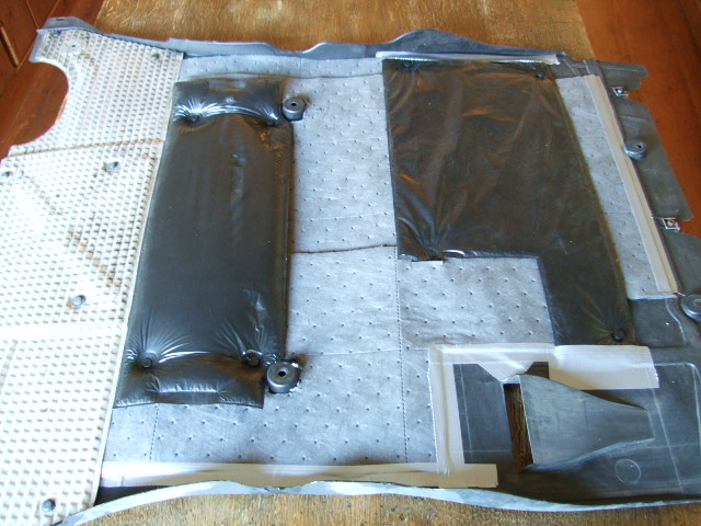

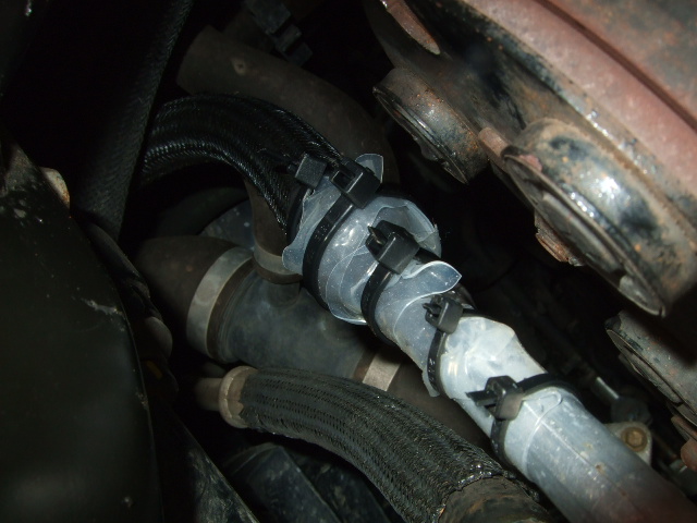

Well plan B has been completed. To make up a new pipe would have required removing the old one, not really an option at this time of year, so repair it is.
Solution was to clean joint from any trace of ATF, methylated spirits. Then I used a epoxy weld called here in UK "SUPER STEEL". It comes in two tubes which when portions are mixed starts to chemically react to form a solid bond. Well it appears to have done the job. I applied it around the joint and as a backup then applied tape called KRAKEN tape
a specialist type of self amalgamating tape. The tape job would have been neater if there had been room to get it around the pipe, the area is very restricted.
Have attached photos of the finished repair and the underbelly pan with additional oil absorbing cloth on it. Been out for a spin and there currently are no leaks.
Will check in a couple of weeks. In spring may effect a nicer looking repair. Plan is to cut original solid steel pipe and use a 13mm plumbing fitting, this size only available in France, will pick up on my next visit, as nearest UK size is 15mm. Steel pipe has OD of 12.7mm, near enough to 13mm.

Well very nearly 6 months since I did the "temporary" repair. Had a look yesterday and all as in the last picture ie no leaks whatsoever. So am going to leave well alone.
