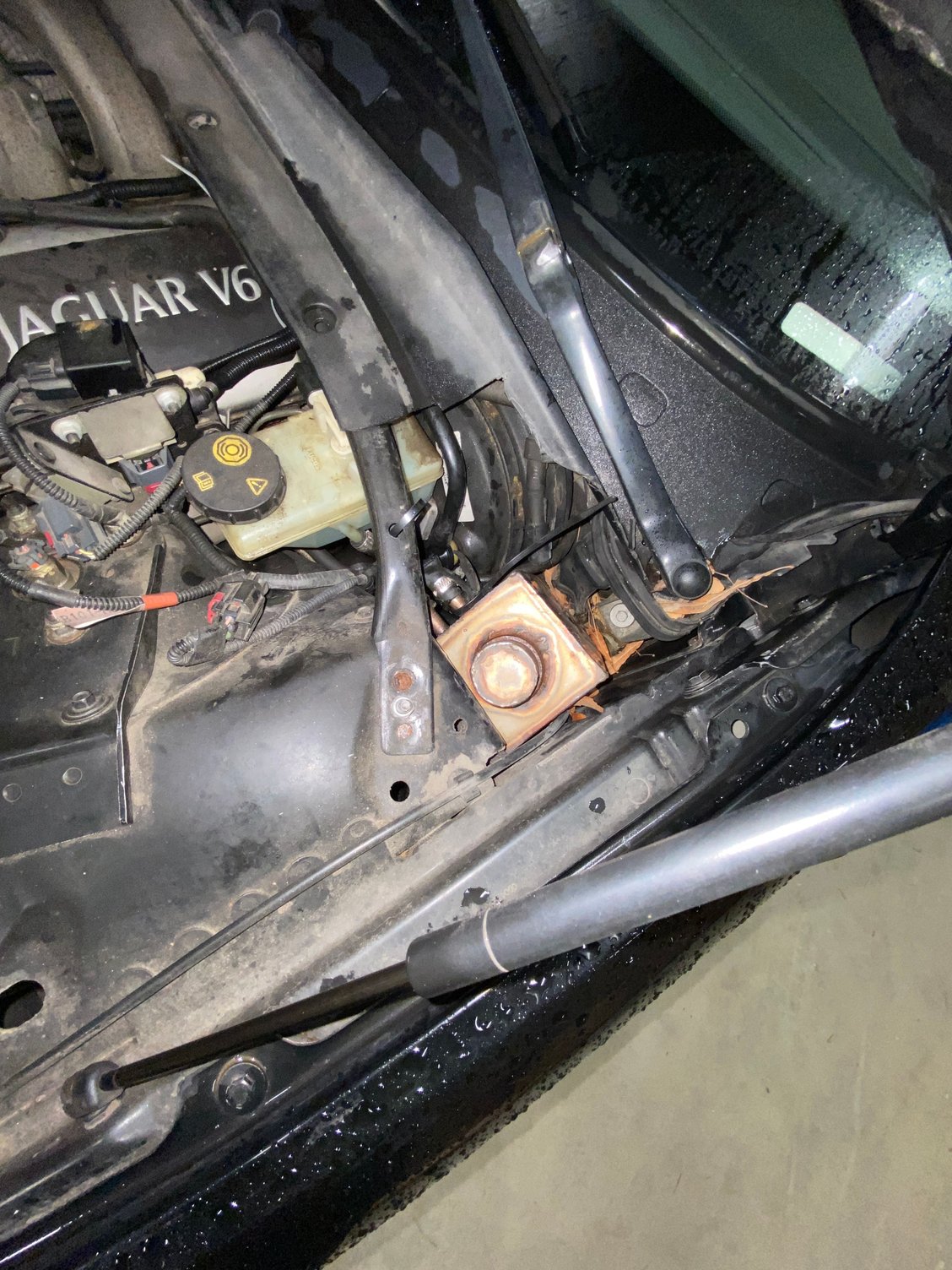

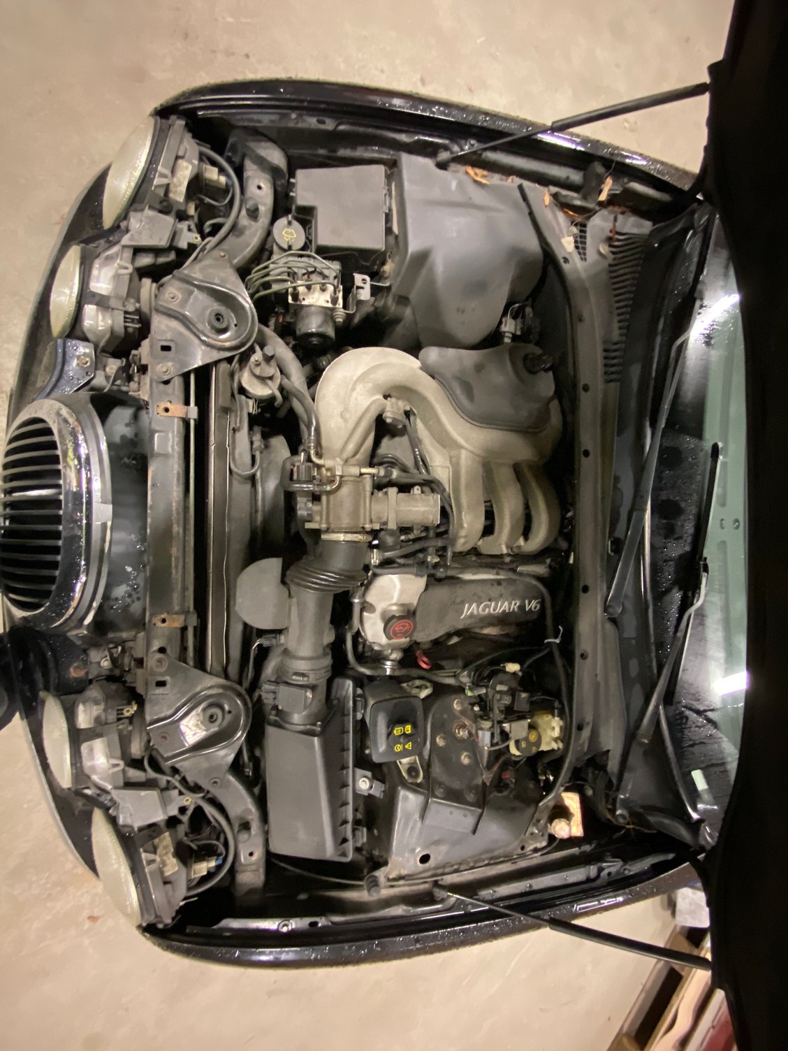

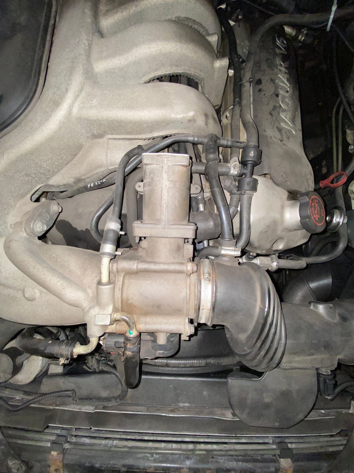

So i really cant find the expansion tank on this car, the previous owner has done something to the car and built a metal box and i dont know if its supose to act like the expansion tank or an oil catchback. See pictures below
Hose from metal box runs to this intersection
The metal box

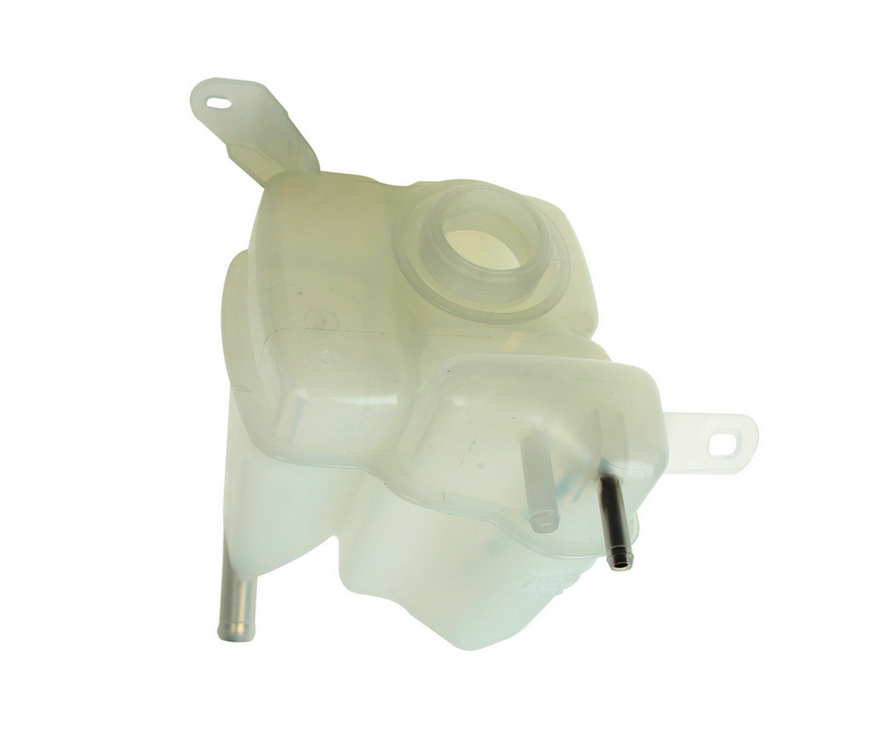

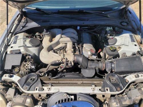

Holy cow! It appears the previous owner has fitted some sort of metal replacement for the coolant reservoir/expansion tank. If done properly, that's one way to make sure it never leaks again.
Here's what the stock tank looks like for an early V6 model:
Here's a view from eBay, showing the engine compartment. You're missing a trim panel forward of the wipers. Actually, it looks like yours was cut. The tank fits under this panel, about where your metal tank is sitting. The panel has a hole in it for the cap on the coolant tank, seen in the upper right corner of this picture:
