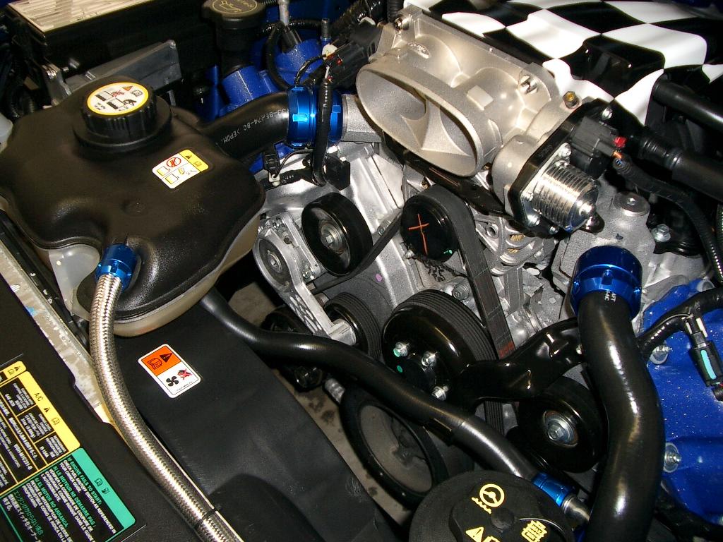

Sure, that's a racing spec STR, mods costing thousands. You can buy a tank much cheaper.

I think, it just cosmetic blue toy rings for kids. Am I right? Is it cosmetic mods?
I figures that as well but, my reason for wanting to do this is so that I wouldn't have to run into this situation again. It'd be great to do but if it's a hassle then I would just stick with the oem tank.

BTW Last picture is a heavily modded '05 Mustang 4.6 L . That is the stock coolant reservoir with maybe an aftermarket bulkhead fitting on the reservoir, or that is just some engine dress up bits....I knew the guy who owned that car on line in mustang forums, lost touch with him or I'd ask...

Originally Posted by Jimmy 68
Just get a new stock one. Should be fine for years.
Thanks, my old coworker has one and had the same kind of hose attached to his reservoir. It'd be great to be able to do the same so that at least I'll have peace of mind that the piece wont be breaking off over time. I have the replacement one here but now I am stuck with 2 things finding the correct upper radiator hose with the attachment and installing both the hose and the reservoir tank. Any ideas??
