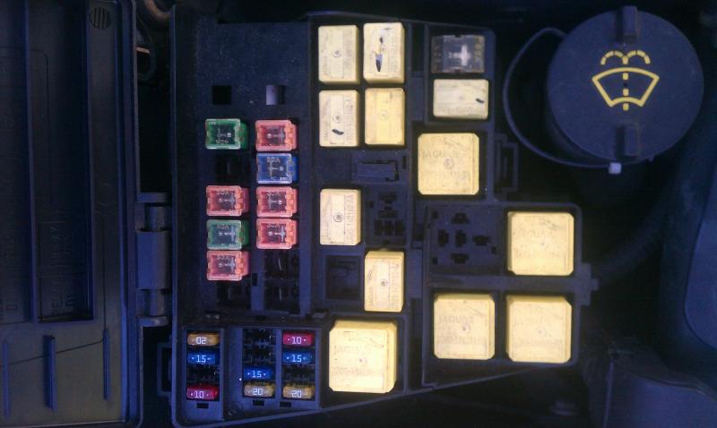

Is it possible that missing one relay could disturb entire system?
Currently I am having trouble with my wiper which do not work and
I have checked the fuse relays and there two relays on the wipers, relay
11 and 12
11. LH heated windshield relay and heated wiper
relay
12. RH heated windshield relay
I have find out that relay 12 is missing and if one of those is missing,
the wiper could not possibly working?

Do you have the heated windshield wiper park option? If you do you should have a front heat button below and to the left of your defrost button on the HVAC panel. (I'm going to suspect you don't if relay #12 is missing. (or did you remove relay #12 to put it elsewhere?)
Please also provide vehicle info for more assistance.

OP definitely doesn't have heated windshield wiper park option, explaining empty relay socket.

when and how did your wipers stop working ? are they parked or upright ?, have they ever worked ?

My car is 01 3.0 gasoline
the wipers are in park position
its been stopped for about 6months and it stopped after the fixing the AC part
behind the glove box
Hope I answered the details

ok, so it sounds like something has been dislodged and/or a fuse has blown, test the wiper motor wires to see if you have any power going to them, that will tell you if it is the motor or not.

It was the blown relays 1 and 2
