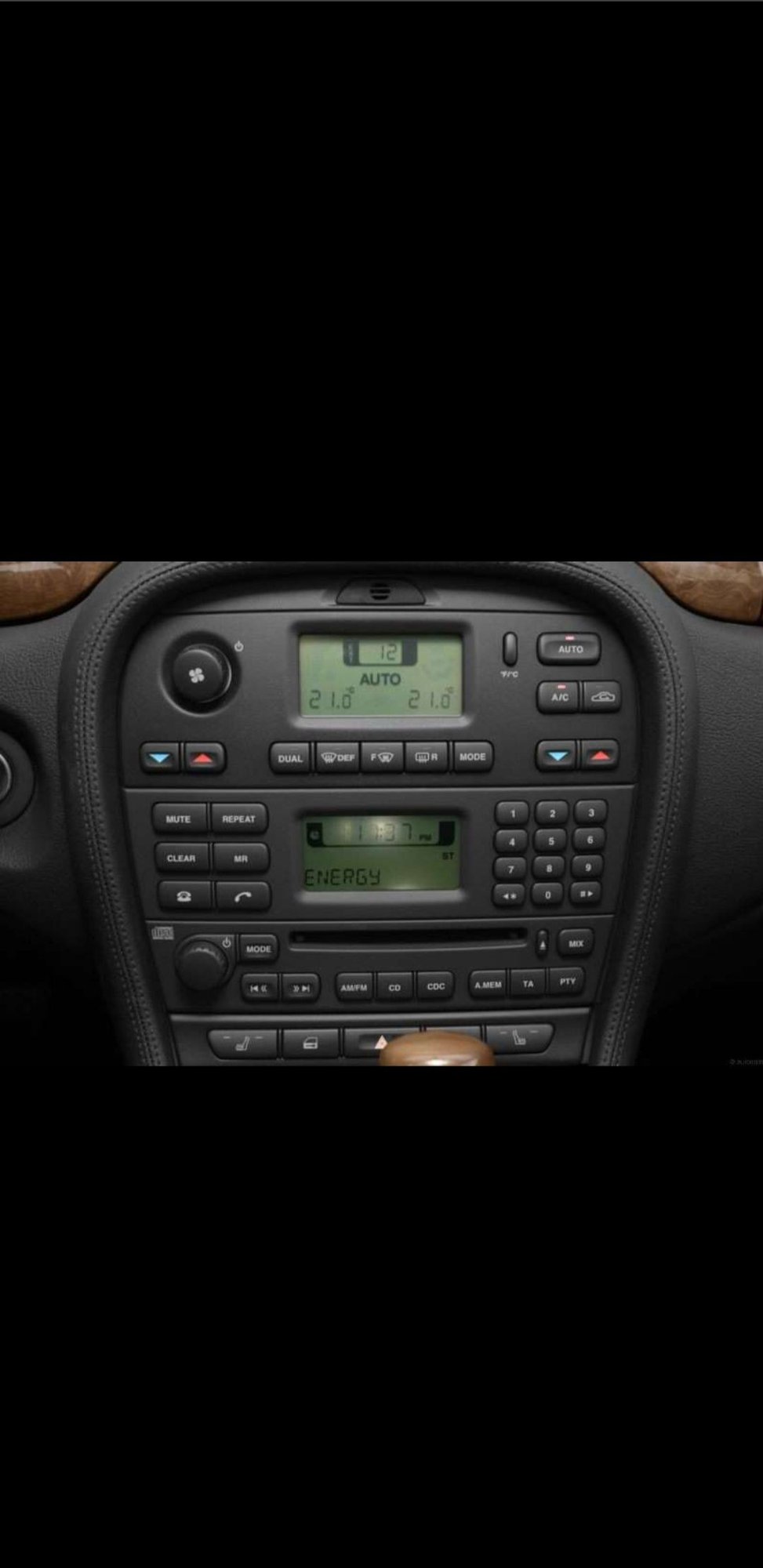

Below is a picture of what I have

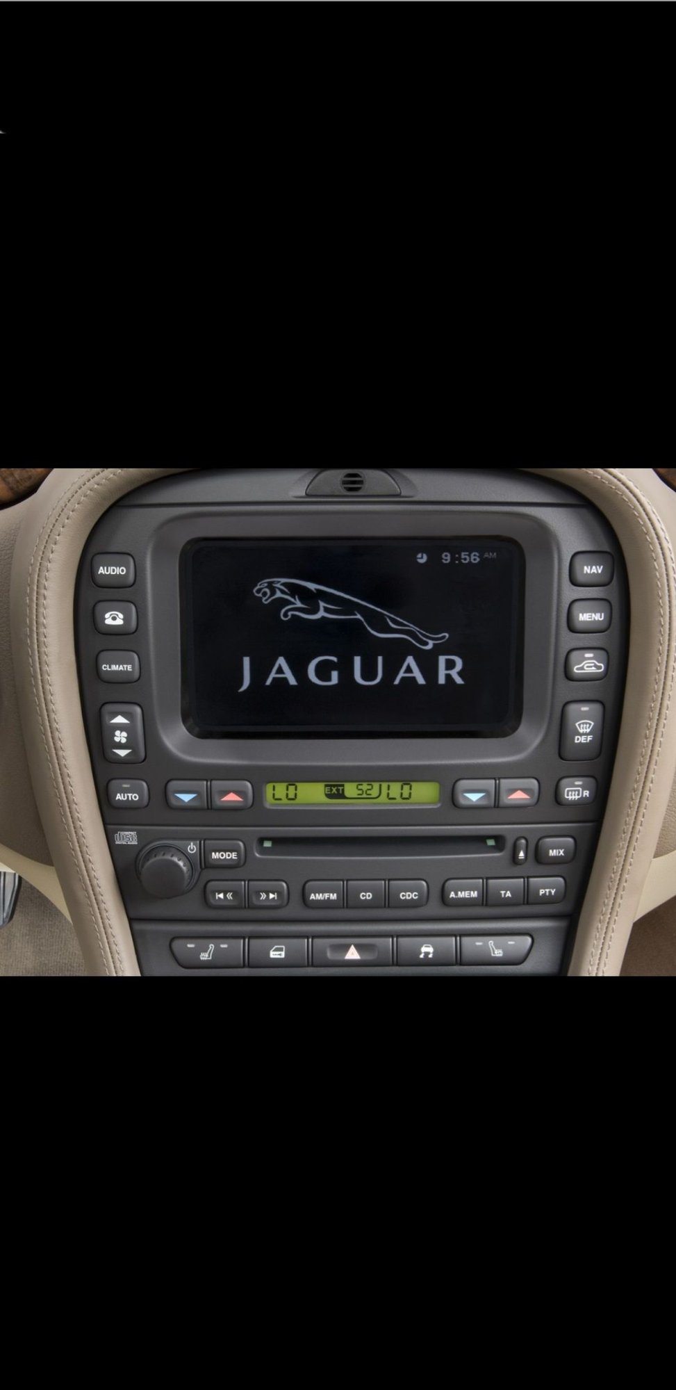

And what I would like to install

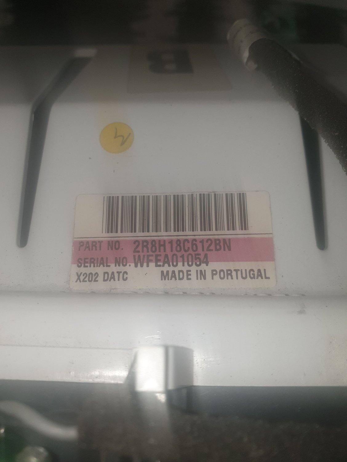

I also decided to pull out the control module and never noticed it before but has different part number and says X204
and I think it could be from a Diesel s type
As one fault always says Auxiliary motor failed to start
but were told just to i Ignore it
Yet my original has x202
Have attached some pictures
Thanking you Darrol

If upgrading the radio I hope you have a non-navigation car? It was not clear from your post. If so those they are not too difficult to upgrade. But if you have navigation that is a whole nother ball game and good luck! I don't know if anyone has replaced that but I have seen stuff like JagDroid? This keeps the factory screen and allows more more things to be displayed.
JagDroid Android Upgrade
Take a look and I think it's very well done to. Do read the limitations to make sure that won't be a problem for you

Also I am not sure what module you show above? Which one is it?
