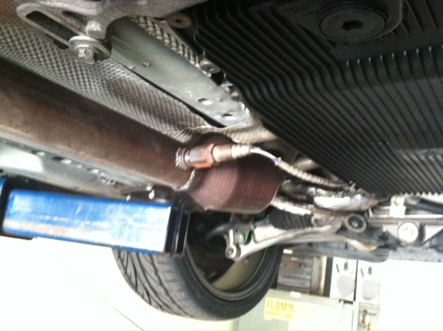

Originally Posted by bfsgross
underpressure, can you post pics of O2 sensors?
I had the car on the lift again today to cure leaks at flanges, so I snapped some pics for you bfsgross. These are pics of O2 extenders installed (one pic shows both cats and both extenders, the other is just of the driver side cat & extender)....
Huge thanks to Billet Design Motorsport in Pompano Beach, FL for getting me in so quick and taking care of their post-install leaks so fast while I waited 15 mins.
Old Jun 27, 2012 | 03:18 PM
  #57
bfsgross's Avatar
Joined: Nov 2009
Posts: 5,084
Likes: 432
From: NY
Default O2 extenders
Sorry for incorrectly explaining the O2 sensors. Thanks to UnderPressure for posting the pics.
Old Jun 27, 2012 | 06:37 PM
  #58
jag79's Avatar
Joined: Jul 2010
Posts: 1,178
Likes: 86
From: Orlando, Florida
Great pics! Just one question, you used the Extenders on the o2's only on Downstream? or also on the Upstream o2's?
Old Jun 28, 2012 | 10:33 AM
  #59
bfsgross's Avatar
Joined: Nov 2009
Posts: 5,084
Likes: 432
From: NY
Chris, the extenders are to be used only on the downstream O2's.
