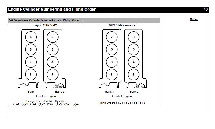

really quickly anyone please,
in a uk 2002 v8 does the cylinder numbers go 1-4 on the drivers side, uk car driver is left hand side if stood facing the engine,
and 5-8 on passasnger side, facing the engine it would be the right side of car?
correct or not?
Old Dec 28, 2012 | 01:48 PM
correct or not?
Bad MY for this question as it changes at 2002.5!
This is from the Model Spec Brochure.

thanks graham if my model year was up to 2002.5 then how would i know which cylinder number 7 was?
Old Dec 28, 2012 | 04:16 PM
JagV8's Avatar
Posts: 27,546
Likes: 4,924
From: Yorkshire, England
4.0 is always pre-2002.5MY, which starts at (last 6 of) VIN M45255.
All directions - worldwide, all cars - are as if seated in cabin facing front.
Please downlaod the FREE files in the stickies such as JTIS and Vehicle Specs as all these are in them.
