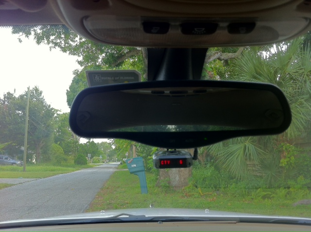

NvmyJag...Where is your wire exiting relative to the trim pieces? Did you have trouble getting the trim pieces back on? I spend a half hour and I was unable to get the upper and lower trim pieces back on correctly, the bottom piece spread out extremely wide at the top and wouldn't meet up with the bottom of the upper piece...
I went out and took a pic to give you a better idea of where the wire comes out
I ran the wire between the two pieces where they meet and yes, it was a pain
The problem is that the inside of the mirror covers have grooves. You have to get the cord in the right groove for it to not bulk out. I started to dermal out the inside of the cover to make it easy but it finally snapped together
. I hope it helps!

I saw someone bumped this old thread on how to install (hide) the power wire for a radar detector. I wanted to help anyone else thinking of doing this by saying you do NOT have to take the mirror apart at all to hide the wire inside the mirror. You simply tuck the wire under the mirror. Bada-bing, bada-boom. Easy. (The center console has to be taken apart, but I'm simply adding info about the mirror.)
You're going to need to extend (splice) the power wire, so get a small gage speaker wire, cut the radar's wire shortly after the tip of the radar detector's wire and splice your extended speaker wire on, then wrap it in black electrical tape (to make it blend in, being black wire). You'll then continue to tuck and hide the wire along the seem of the windshield and roof, then along the side airbag(!) pillar posts and windshield (be CAREFUL not to block or do anything stupid around the side airbags, 'ight?). Then, run it through your center console for power (I like leaving the ashtray's 9V free as an always available power source for guests, you should too).
Here's a thread with some images you can see my radar detector smoothly blending in with the mirror.

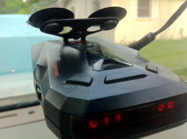

What's up Rob, I think I can answer your question, or at least give you some food for thought. Radar can penetrate glass, plastic or other like materials. Radar can't penetrate metal. But, that's for radar... most law enforcement officials use laser. Laser is defined as beams of light, so your radar detector MUST be able to see through your windshield in order to pick up laser. Many experts recommend mounting a radar detector as low as possible because cops using laser point the device to your bumper area.
Mount Detector Properly - RadarBusters.com
If you have a simplistic radar detector (most do), then this is fine enough... But, some radar detectors come with 360 degree detection. The little curvy "nipples" on radar detectors, in my experience, aren't effective. Radar detectors that have large windows, ideally angled (like a prism) are the best for offering REAL 360 detection. You can see on mine exactly what I'm talking about.
And there-in you have your dilemma. Where do you mount it? It clearly can't be mounted in the standard "expert" location of "velcro'ed to your dash", being as low as possible, as this clearly blocks all angles but the front. Thus, the only non-intrusive position to clear the rear window, sides and front is directly under your mirror. I have witnessed a cop shoot my car after I had gone past and my radar gave me a laser indicator, which was directly through the rear window.
I've taken a picture from the angle directly paralel to the rear window. You can see the radar's just high enough for the rear sensor to "see" out the back, but not so high as to block it (note how straight and level it is also).
So, now you know a little about positioning... How much detection ability are you losing by not having it mounted on the windshield? That's "up for debate", but yo... you want my honest opinion? If radar detectors aren't illegal where your at, it's stupid not to mount it on your windshield. Put that baby up. Got a 360 radar? Mount it just like mine is. Got a standard front only one? Mount it like mine or mount it to your bottom driver side windshield and ENSURE it's level and not pointing in some crazy angle. JbB
