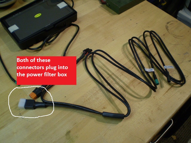

That's not the failed part according to your description of what is going on... There's A black filter box that that plugs harness plugs into. (You can see the white connector leading to it), then there is the main harness that has the connection to the control panel. The fault is in THAT harness if the screens are getting power but the control Panel isn't.
Dan any possible way you or anyone else, could post a pic of an intact harness on a bench?

.....George are you asking for a pic of the Y- Harness cable that came with the package? like this below.

Ideally a pic of the whole harness laid out would be great. His problem is in the the harness that has the power connectors to the screen harness AND to the control panel.
If that makes sense. The screens are getting power, the control panel isn't.
George

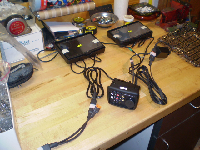

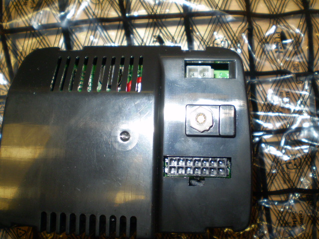

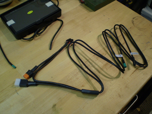

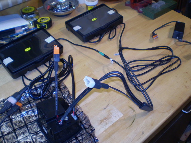

From: Akron, Ohio USA
Default Part1 Components

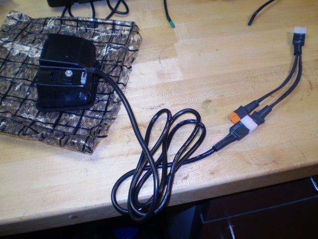

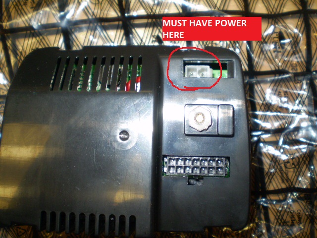

Here are the components of the Video System:
Power Splitter: Used to tap into cig. lighter power
Control Module: Self Explanatory, two connections, See Picture
PowerFeed: From the Splitter to the two wire connector on the Module
Screen Harness: Goes from the Module to the video screens
Power Filter: Attaches to the connectors In-line on the Screen Harness
Next is hooking them up.....
Oh, BTW, I know the screens are sitting there out of the headrests..LOL.. This is the "gutted" system that I have to retro-fit into our Grand Caravan! Why, you ask? This is actually the perfect little kiddie system.. Totally detached from the audio system, able to switch each screen independently between three sources.. Aux1, Aux2, and the media reader... Also, one passenger in the far rear seat can have a portable DVD player with Aux out... and hook it up to the two screens at the same time... This is how we used it in the S... Arianna would have the portable up front, and it would feed the screens in the back... All three watching a movie!
Attached Thumbnails Rear Video System Install-powersplitter.jpg   Rear Video System Install-powerfilter.jpg   Rear Video System Install-powerfeed.jpg   Rear Video System Install-screenharness.jpg   Rear Video System Install-controlmodule.jpg
Old Feb 13, 2011 | 05:31 AM
  #92
JOsworth's Avatar
Joined: Jan 2009
Posts: 3,390
Likes: 195
Default Part2: Da hook up...LOL
So, the connections are pretty straight forward..
1) Plug the splitter into the cig. lighter power source of your choice. I used the ashtray one just so I could "spread the wires out" and not have to bunch them up under the console. But I had the center stack out anyway to move the Sat. Radio control module..
2) Plug in the Power Feed between the newly tapped power source and the control module.
3) Attach the Screen Harness to the Control module and the screens.
4) Plug in the Power Filter to the Screen Harness.
5) Thats it...
Here it is all connected..
Now... If I only knew what blade on the power connectors was positive and what blade was negative... Hmmm the one facing | or the one facing _ ???
Attached Thumbnails Rear Video System Install-powertomodule.jpg   Rear Video System Install-moduletoscreen.jpg   Rear Video System Install-addfilter.jpg   Rear Video System Install-wiredsystem.jpg

Jeff you the Man!!! Thanks sooo much for this layout and connections. I may actually do this myself now instead of finding an installer for it.
Great Job!
....Jeff two question; 1) did you put those heat shrink wraps on those cables? or they came with the unit? 2) Where is the Y-harness being used in the pics? Is that the same thing as the Power Splitter you used, I don't remember seeing that included in the package as of the contents.

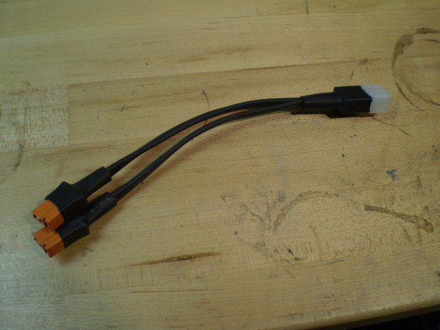

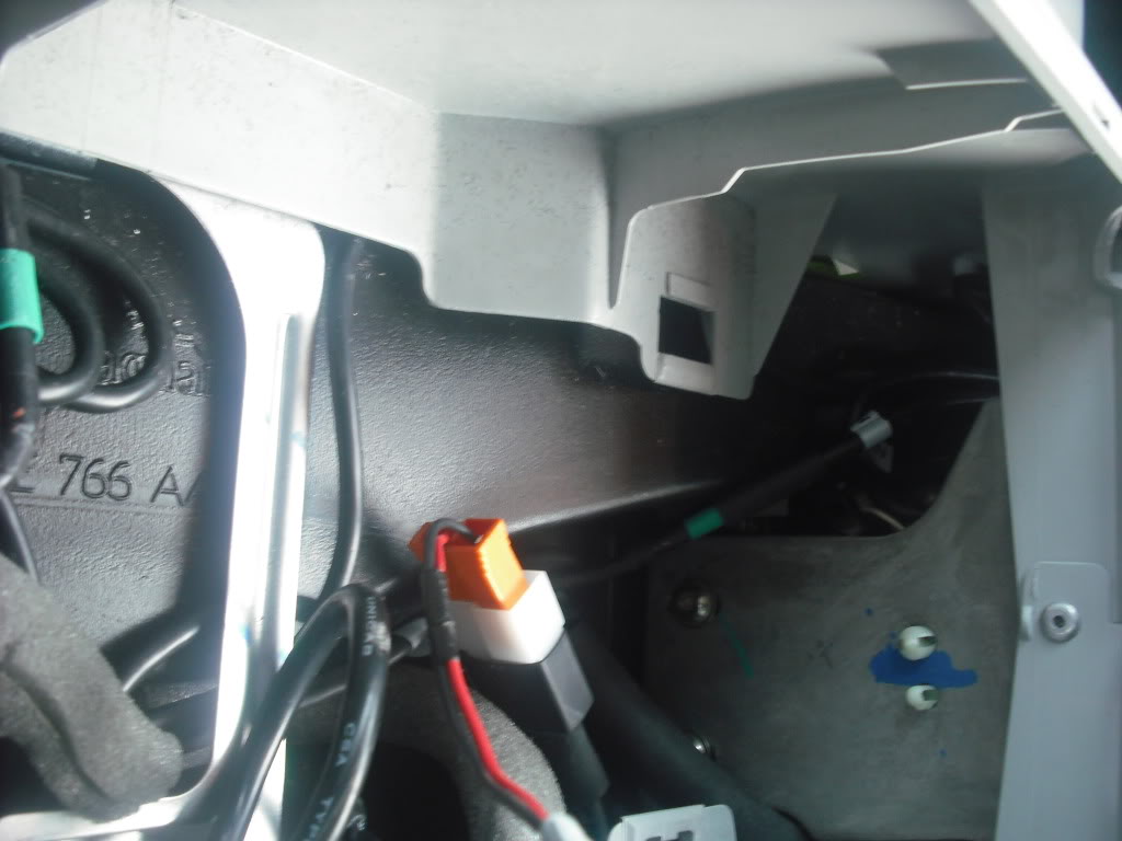

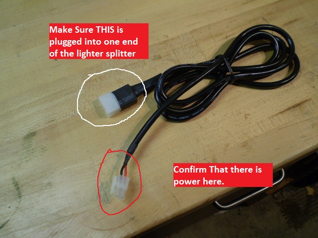

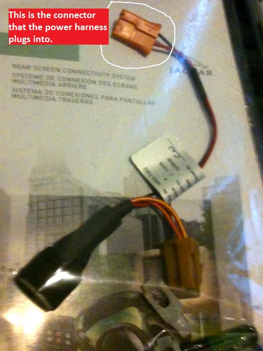

Jeff thank you SO much for that.
There's one difference with an S-Type kit. The power splitter that jag 79 posted instead of yours. (Which has the big insulated ceramic base to acomodate the lighter element of the power point).
IT looks like this:
Now here are the connections that Davo0705 needs to verify:
FIRST I have a feeling I know what's wrong with his system. My guess:
His installer plugged the power filter input directly into the lighter power source from the splitter Thinking that the entire system used filtered power
He then plugged output of the power filter into the screen harness where it normally goes, AND then plugged the power harness into the screen harness where the input to the power filter should connect.
This would give the screens filtered power BUT Not the control panel.
Now here are the proper connections. Btw Jeff you can figure out the plug orientations as far as polarity using the power harness and checking continuity at both plugs. The side of the power harness that connects to the control panel has the wires to the pins color coded.
HERE are the proper connections, and what davo has to check.
Jag79: Jeff posted pics from an X-Type kit. His splitter is different than ours. I used your splitter pic because that is the one that came with the S-Type kit.
The difference is the ceramic base that is designed to hold the heat of the lighter element.
Take care,
George
Attached Thumbnails Rear Video System Install-photo.jpg   Rear Video System Install-powerfeed.jpg   Rear Video System Install-controlmodule.jpg   Rear Video System Install-powerfilter.jpg   Rear Video System Install-screenharness.jpg

Yea, it is easy to do yourself...Plus you know that you'll take the interior parts out carefully...
1) Those cables came that way..
2) Yes..What I call the splitter others call the Y harness. Yours may look a little different, but if you look at the connectors they are essentially the same... (The kit your looking at is for an X Type, but the components are the same since I had both).

George and Jeff both of you guys did an excellent job on explanning the connections. Thanks for clarifying up the Y-harness(S-type) being the same as the Power Splitter harness like on the X type .
Few questions though for the the two of you.
1.In the pic where George made the white circle on the Y-Harness(brown Connector). I understand that the white circle goes to the Power Harness circled in white, and the black colored heat shrinked wrapped big base goes to the Cigarette lighter. Now what about the other BRown connecter?? Where does that go?
2. In the pic of the Power Harness you have the REd circled, just to clarify that goes into the back of the control unit Power outlet where you have it circle red on, right? I understand that the White circle on the Power Harness will connect to the white circle on the Y-harness.
Thanks again for all your help.

Answers:
1) To the plug coming from the car that originally plugged into the lighter.
2) Yes, that is correct.

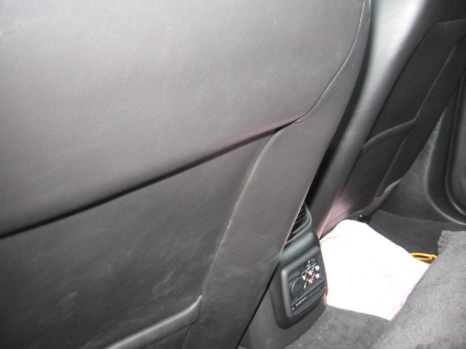

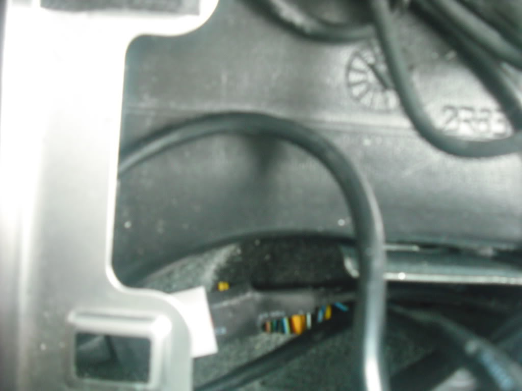

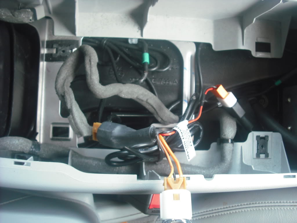

Jeff concerning your install of the Control Module being installed in the rear below the A/c vents. Did you have to do any cutting around to fit the the unit with the bezel? Also do you have any pointers on what to look out for or get around while doing that install in the rear. I'am aware from your previous post about being careful with the air duct. Is there a way to avoid removing the duct?
Thanks for your input.
